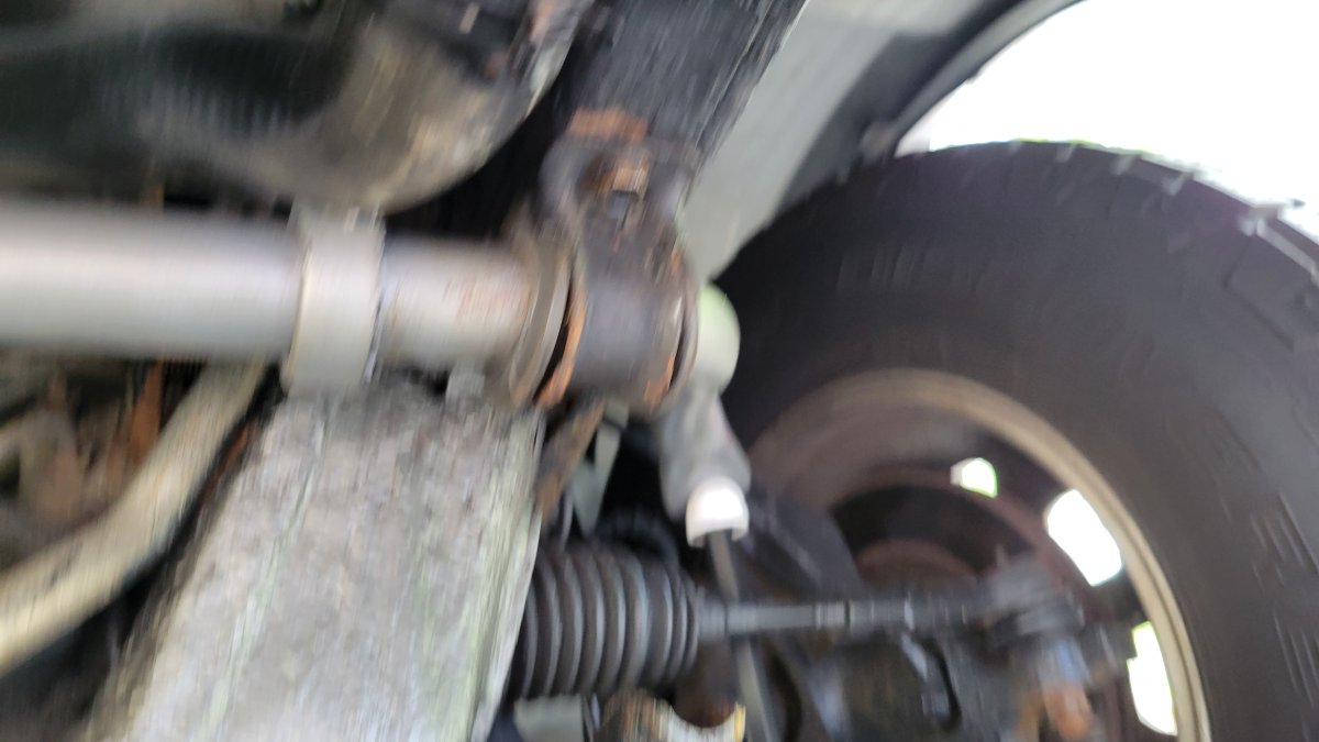

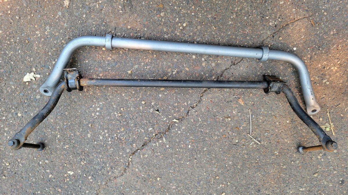

I lowered my Edge from 3" to 2". I changed out the 2" lift blocks on the back and replaces them with ones. I cranked down the front torsion bars as far as they would go (about 3/"). I widened my stance with slightly off set wheels and put bigger tires on the bottom. My tire diameter is 30" but the width is about 10 1/2. Taller is not better for the street, especially at highway speeds.

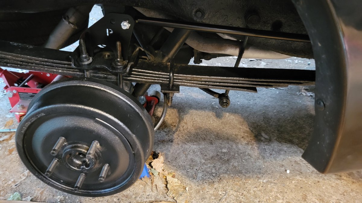

I took the squidgy feeling out of the rear by adding spring pack clamps, the very same trick on my MG. James Duff traction bars help smooth out the corners. New shocks helped. Maybe the best improvement was a 1" Ford Explorer sway bar on the front end.
Front sway bar and the 1" Explorer replacement.
James Duff traction bar and leaf spring clamp mounted 6" in front of the axle.

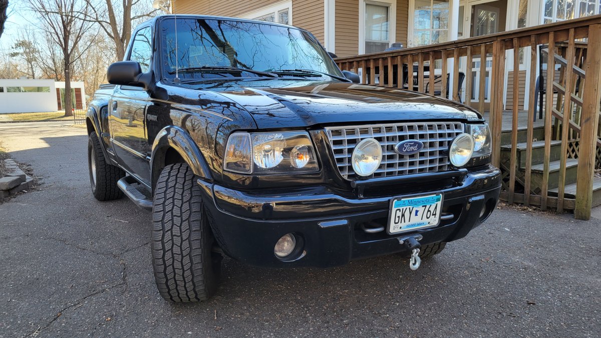

10 1/2" tires slightly offset on Pro Comp wheels.
This Ranger is still higher than others but handles extremely well and does so without a harsh ride.
