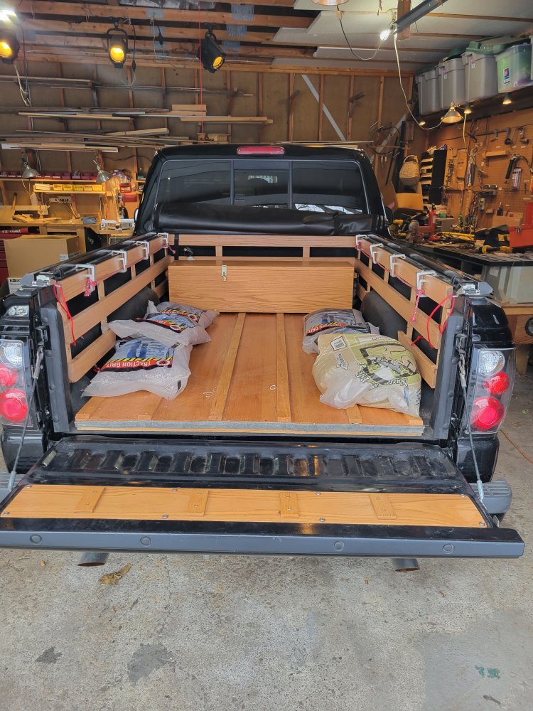

One other thing that is likely contributing to your situation is F/R weight balance. These trucks (especially regular cab/short bed) tend to ride a bit softer with some weight in the back. You could experiment by throwing a few sandbags or something similar in the back of the bed and see what you think. If that helps, then you can consider something more permanent and less intrusive than always having sandbags in the back.

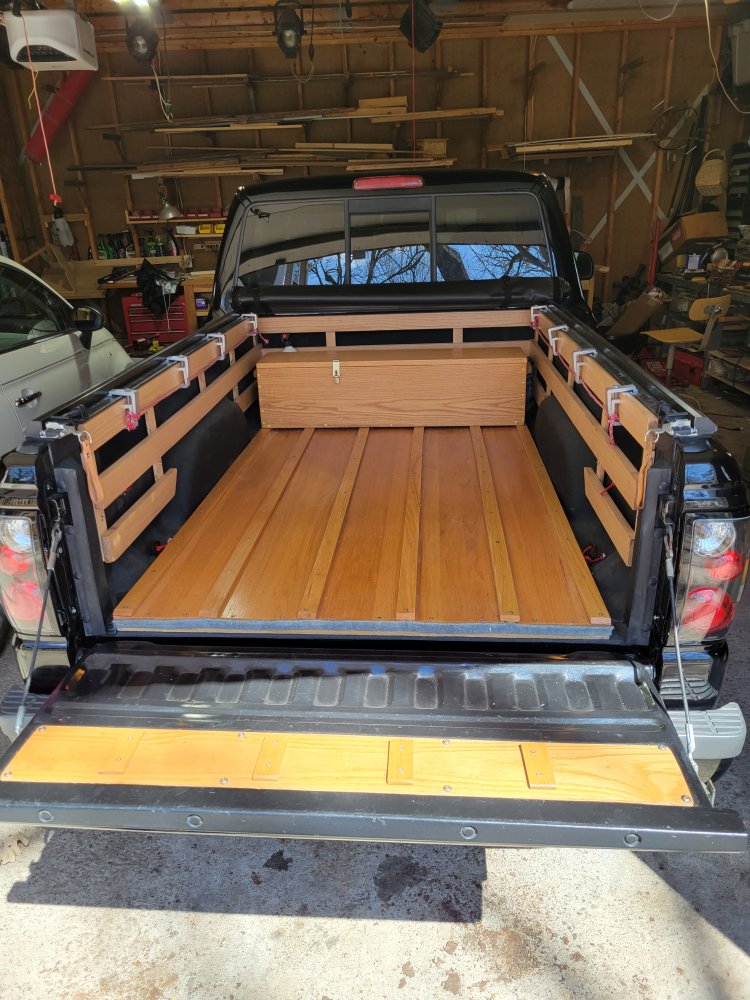

Good point. If you don't always need all of the space, consider a tool box. Also, I've got an oak bed. It does "smooth out the ride" a little and improve F/R balance. This year I'm putting in a larger tool box. The tools come in handy and

oak itself is rather heavy. A tonneau cover and a couple coats of spar varnish protect the finish from the elements. It is durable but prone to scratches. Most of the time I fill the bed with cardboard boxes, but sometimes I use cardboard or a moving blanket to keep everything looking new.. An extra coat of varnish from time-to-time is also good. A more durable finish could be bedliner. A cheaper solution could be plywood. Either way you add about a hundred pounds of weight, maybe more, depending on those tools.

Sandbags are cheap and easy to use as experimentation. Once you know if you like the way it rides with weight all the way in the back, then you can do something more permanent and discreet like a battery relocation, fuel cell, etc. Those would add little overall weight, and would just move it around to improve weight balance while keeping the bed available for utility.

This years winter I carried around a ton of tires to add some weight to the back, and I'll be doing something similar again this winter. It's still really annoying when you do in fact need the bed space however, and have to remove 200-400lbs of junk from your bed just to pick up an ikea order.
