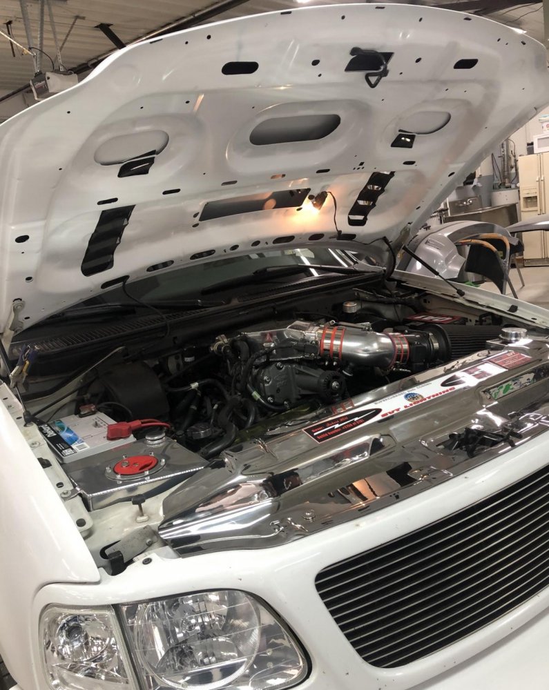

Exactly. On my Lightning I put two Mustang heat vents on the sides of the hood, which along with the cowl, vents a lot of heat overboard. One cold night, I started the truck up and let it warm up while I was getting ready to go home. Never turned the defroster on. When I came out 10 minutes or so later, the windshield was defrosted. During the summer months, I take off that polished radiator cover. That lets some air up over the top into the engine compartment. I can really feel a difference on the front of the supercharger. It usually gets real hot, like fry an egg hot. With the air going over the top, it only gets warm. Radiator has never overheated due to this.
Also, on my Ranger, I whacked up the plastic baffles in front of the radiator to allow some cool air to flow into the engine compartment. It helps. been this way for almost the entire 20 years I've owned it. So let's not hear any downsides, there aren't any.
I am going to put two of the same exact heat vents on my Ranger hood. I already have a large gap at the hood back, due to throwing away the rubber seal that was there. I can look down from the rear and see well into the engine compartment. I already have a former Mustang hood scoop on the hood, with many holes in the hood under it via a two inch hole saw. When it rains, I just shove a piece of tight fitting black foam inside the scoop to keep water out. I keep it behind the seat, jic. The scoop blows a lot of air all around the throttle body / intake manifold. Something I've been working on for awhile now. Going to order the vents from CARiD soon. They're carbon fiber and kind of pricey.

Ford added a cover for the PCM connector on the firewall, make sure thats in good repair and not missing if you have or are going to make a gap in the rear of the hood
PCM connectors had an issue of water intrusion and then corrosion when they were moved to that firewall location, which is why Ford added the extra cover
I'll give it a look-see. But the way it rains here in Oklahoma, and the Ranger being my bad weather vehicle, if it was an issue, I'd know about it by now. LOL!!
The gap at the back of the hood is fairly wide. It's a steel aftermarket hood. Put on by a local body shop in 2015 when I got tired of all the hail dents in the aluminum hood. The fit all around the fenders and front is good. I removed the rubber seal years ago. I seem to recall it wouldn't stay on anymore, so I just chucked it in the round-open-top-file.
You do realize that the better the hood seals the more air is pulled through the radiator which is what you care about cooling not the engine compartment.
More air is pulled through the radiator by a properly functioning clutch fan. Plus, giving the air trapped under the hood someplace to exit, increases flow through the radiator. With a 180 thermostat in my Ranger, the gauge never waivers above the one third point on the gauge. With the stock 195, it should point dead center. So I have no concerns there at all.

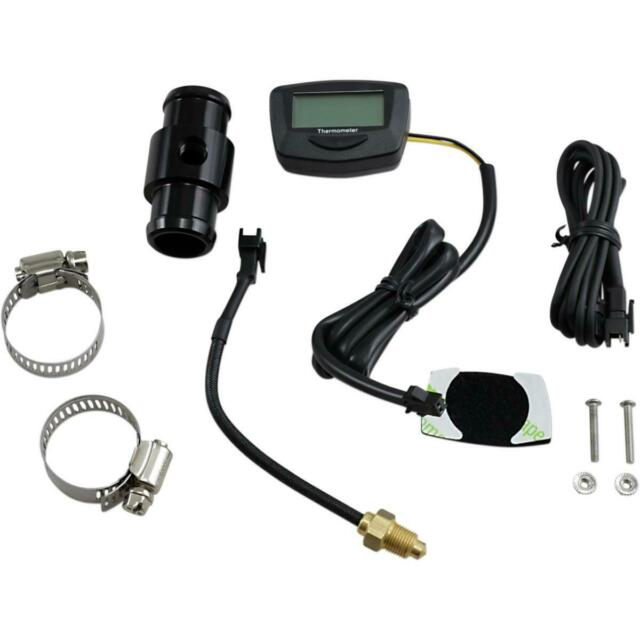

I got one of these digital gauges to better monitor my coolant temp. it runs on battery so no wiring to worry about, just plumb in the pickup, which I spliced into my heater hose line.
