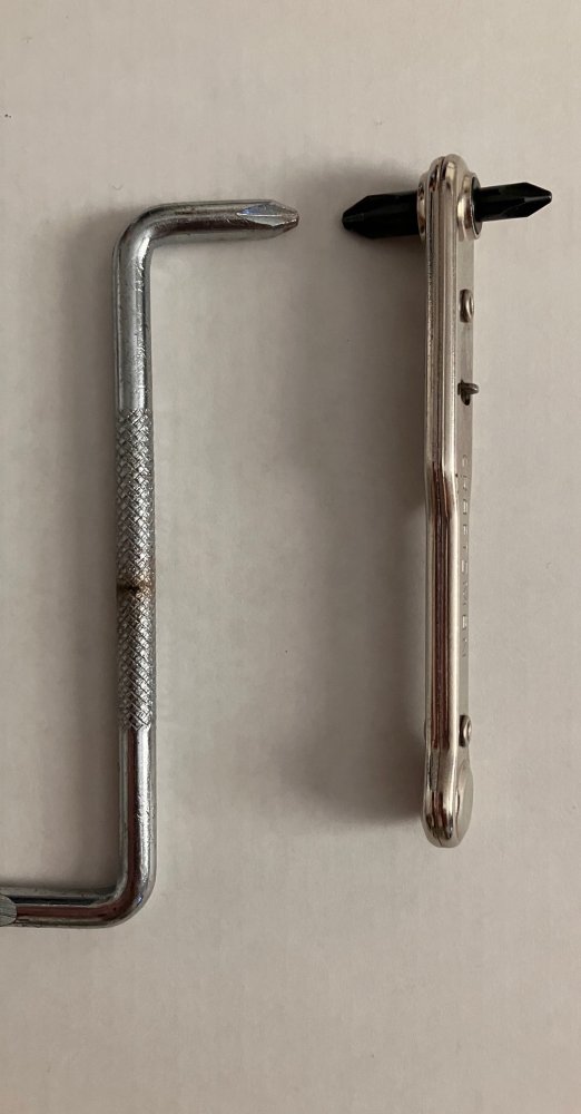

FINALLY got around to moving ye olde DPFE sensor out of the way, and put my inherited right-angle ratcheting Phillips screwdriver (thanks Dad!) to work removing the TPS. Once off, I used a popsicle stick to twist it through its range, to get an idea of how thick of a "shim" I'd need to get that extra 4% at the top end.
