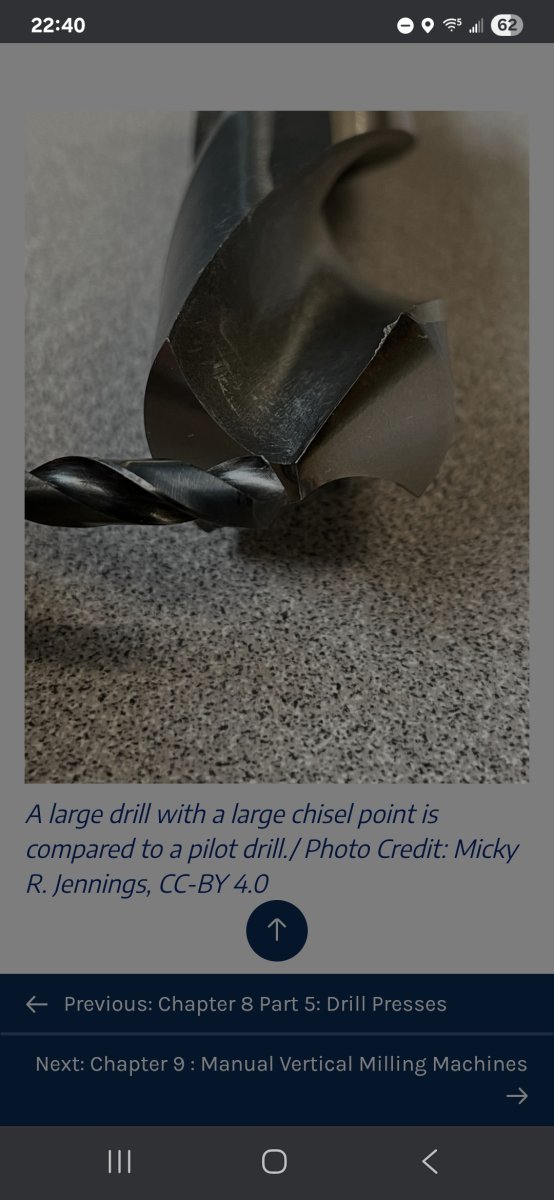

If you look at the point of a drill bit,especially a large one, you see that the center portion, between the cutting edges, really doesn't have a good cutting edge. The tiny 1/8" bit is the same way. But it is smaller and easier to make it cut. But the larger bits don't really cut there. So the smaller pilot hole makes room for the center (web) of the larger bit to go through the material you are drilling. You want the pilot hole to be approximately the size of that center part if your larger bit.

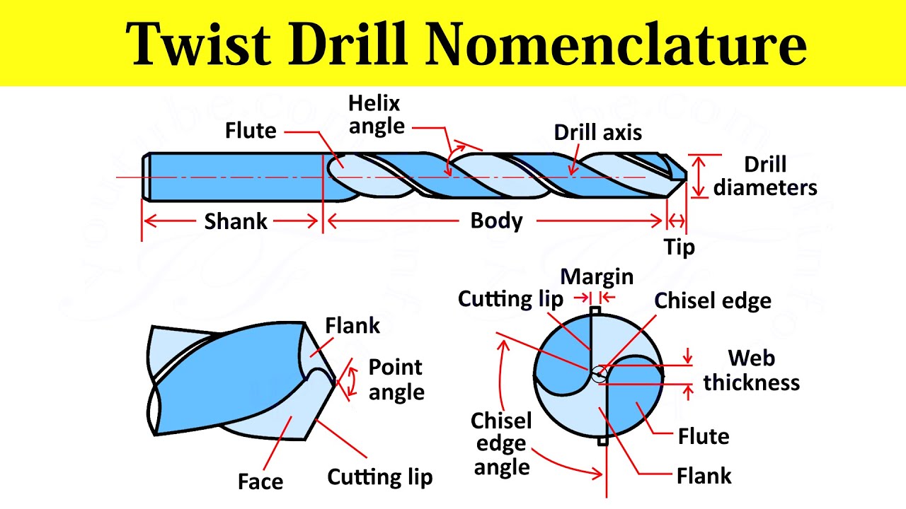

Here are some pictures to help with the idea of the pilot hole.
First, here are the parts of a drill bit identified. Don't go crazy trying to memorize it. Just notice the web and the "chisel point". The chisel point really doesn't cut. You are just forcing it through the material. So, bigger drill = bigger web and chisel point = much harder to force through whatever you are drilling.
Here is a close-up photo showing an appropriately sized pilot drill compared to the chisel point of the larger drill.

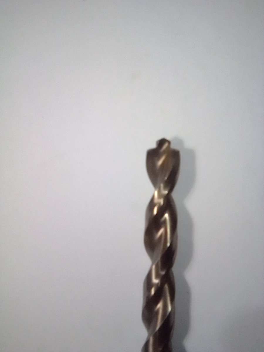

I was also able to take some pictures of 2 of my drill bits today as well.
I couldn't find the other 2 drill bits however.
My brother moved the tools I was using on my truck around so I will have to ask him where he put them.
So here is pictures of the 3/8 bit I've been using and the new 7/16 bit that I haven't used yet.

Notice the bottom of the package says COBALT on it.
From what I understand Cobalt is supposed to be the strongest steel that's made.
Also notice the tips are not like normal drill bits. It has a step down to it.
