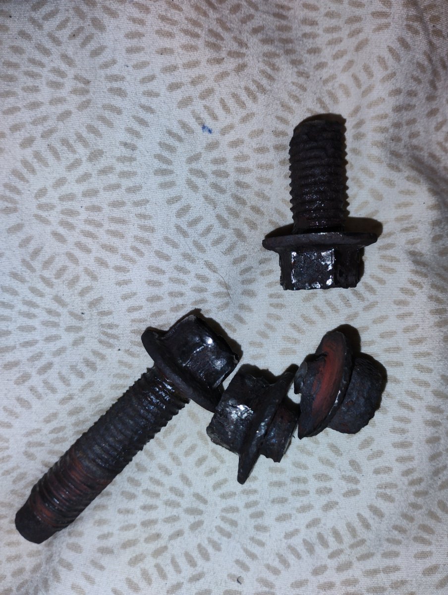

I broke 3 of the exhaust manifold to y-pipe bolts.
The last 1 came out however.
The 3 bolts holding the y-pipe to the catalytic converters ( my truck has 2 catalytic converters)
Are so rusted and corroded I'm going to have to cut them.

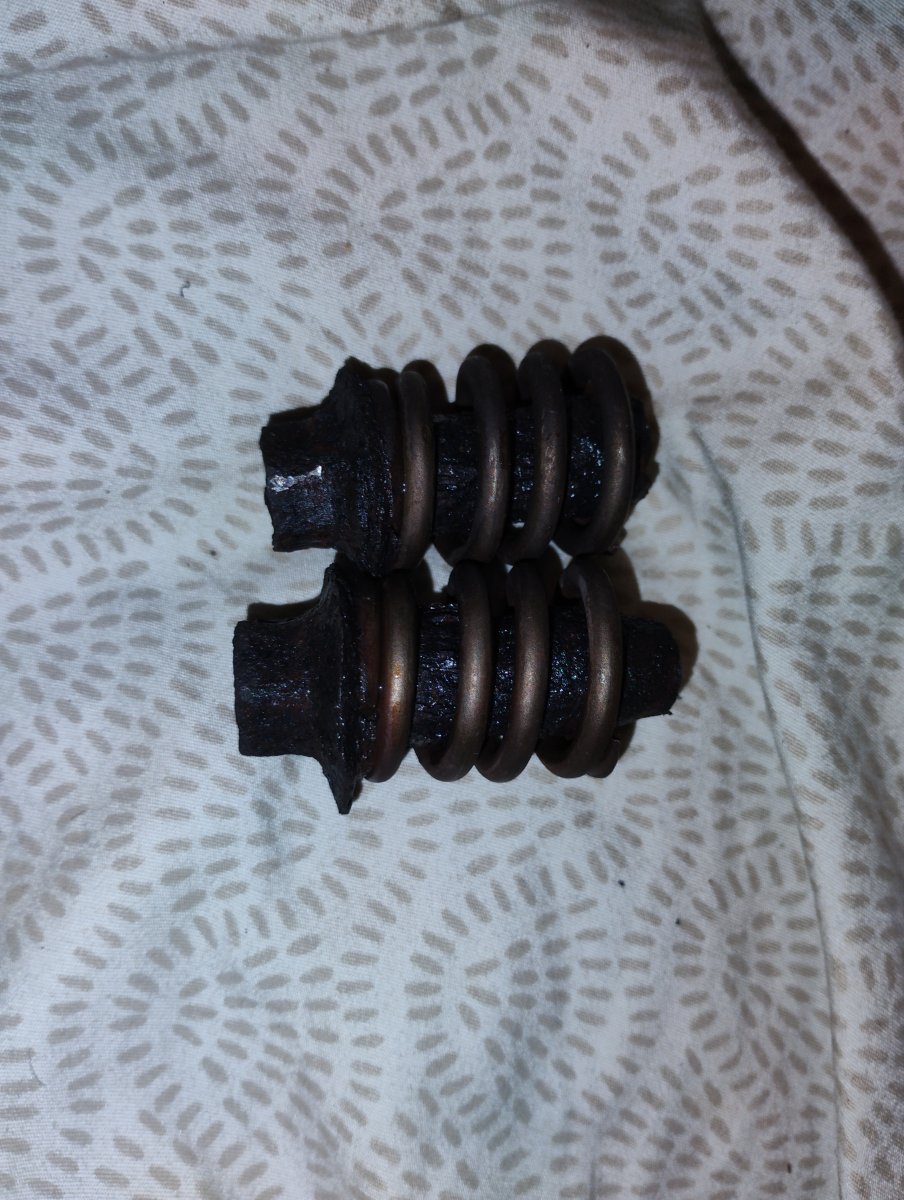

The two bolts with the springs on them that go from the second catalytic converter to the extension pipe was also rusted and corroded I've already cut them.
The other end of the bolts with the nuts was so corroded I couldn't even get a wrench on them.

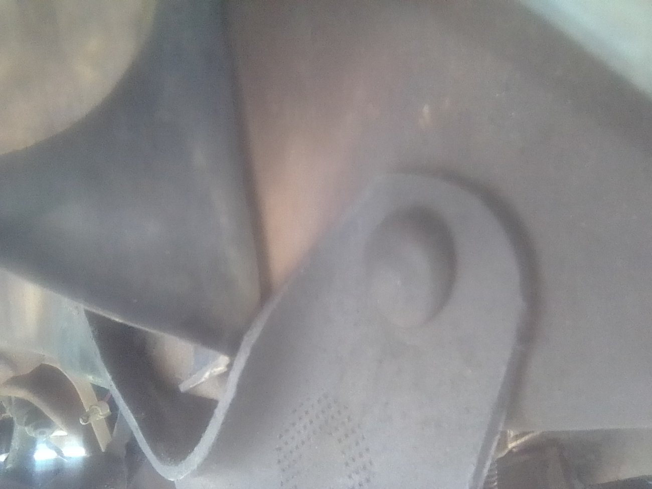

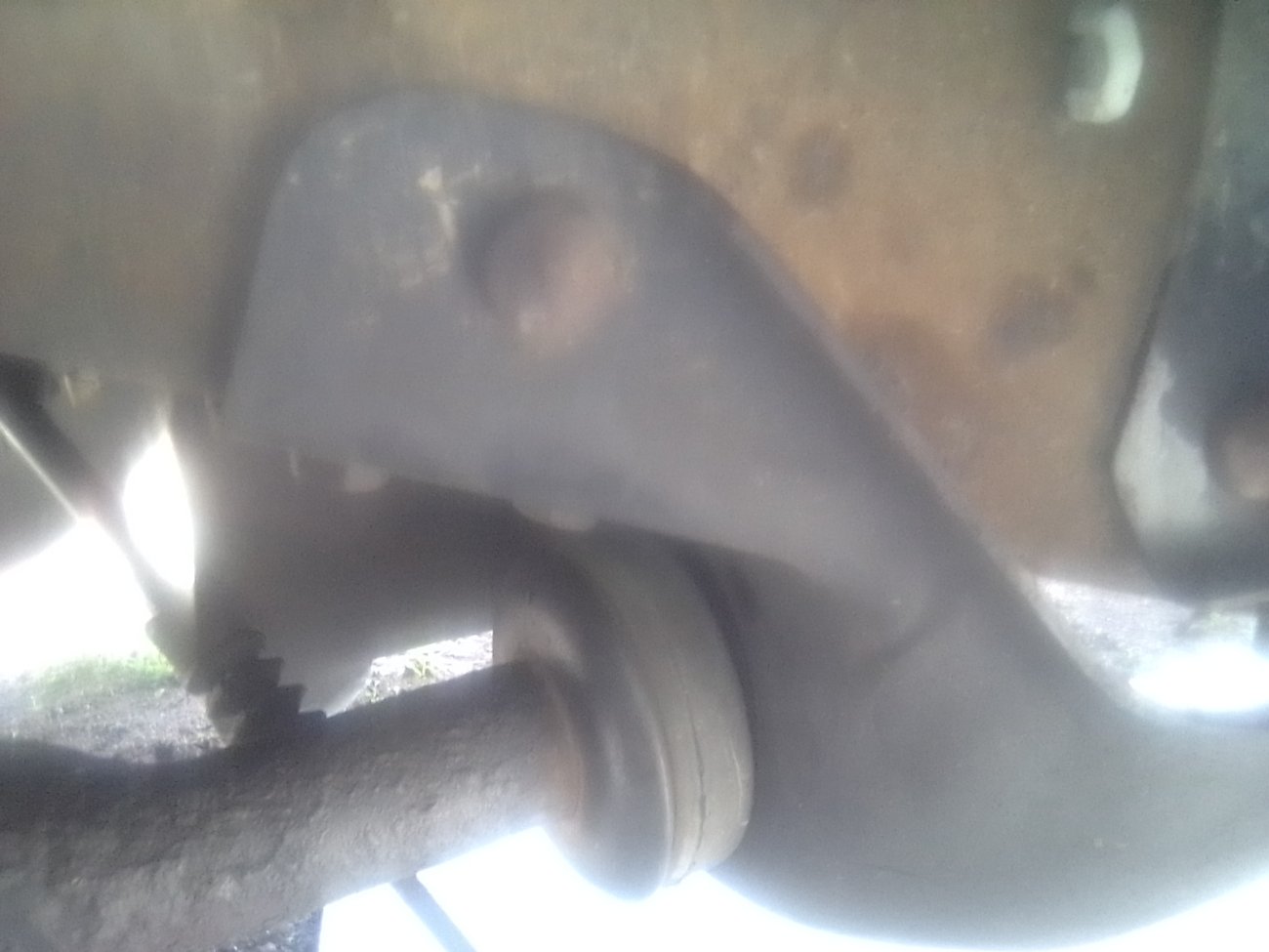

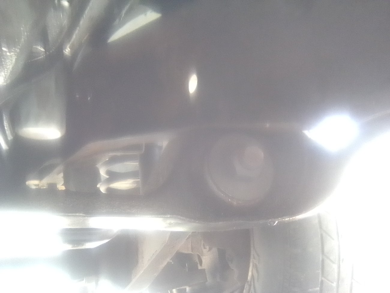

I don't know what the bracket in these 4 pictures is called.
It's underneath the transmission.
I do believe that the name of the 2 arms things that go into it are the radius arms.
It has 2 rivets on each side along with 2 bolts as well, I do believe on each side holding it in place.
It's two separate pieces that are bolted together in the middle.
From what I can see I believe I need to remove this bracket along with the crossmember and the transmission mount to get my transmission out.
Am I right in thinking this?
Sorry about the book folks.
No need to take mess with the radius arm brackets/crossmember. I usually have better luck reaching the top 2 bolts by raising the rear of the transmission after loosening the mount (Watch the fan, it can hit the shroud/radiator.) With the engine & transmission tilted forward I lay across the intake and pull those bolts with a ratchet wrench.

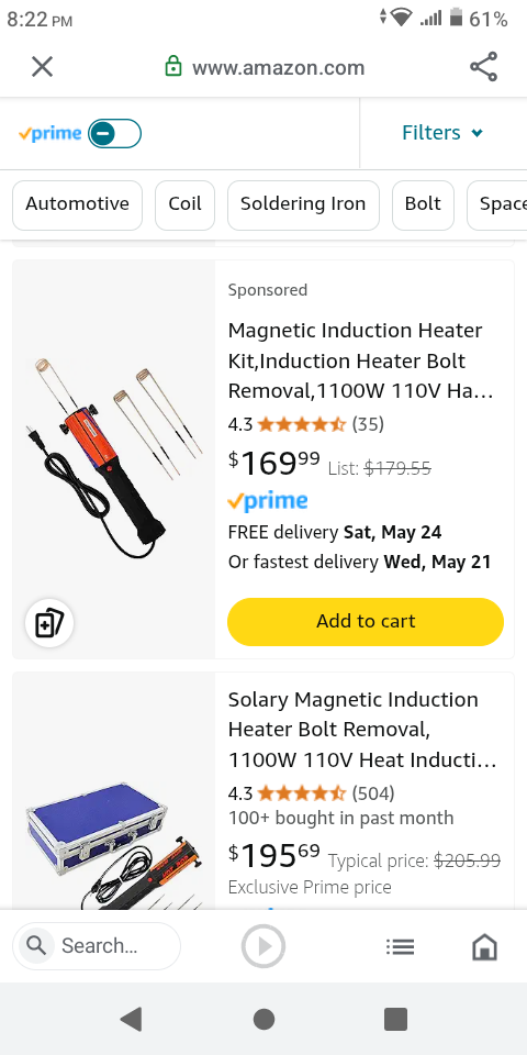

My older brother that helped me with removing and replacing the torque converter to transmission seal told me today about a tool called a:
Heat induction tool.
Looks like the picture below.
Does everyone know anything about using 1 of these heat induction tools to do the job I'm doing.
I'm thinking I'm going to have to buy an oxygen & acetylene torch so I can get the actual bolt studs hot enough to be able to drill through them.
Any and all advice is welcome.
