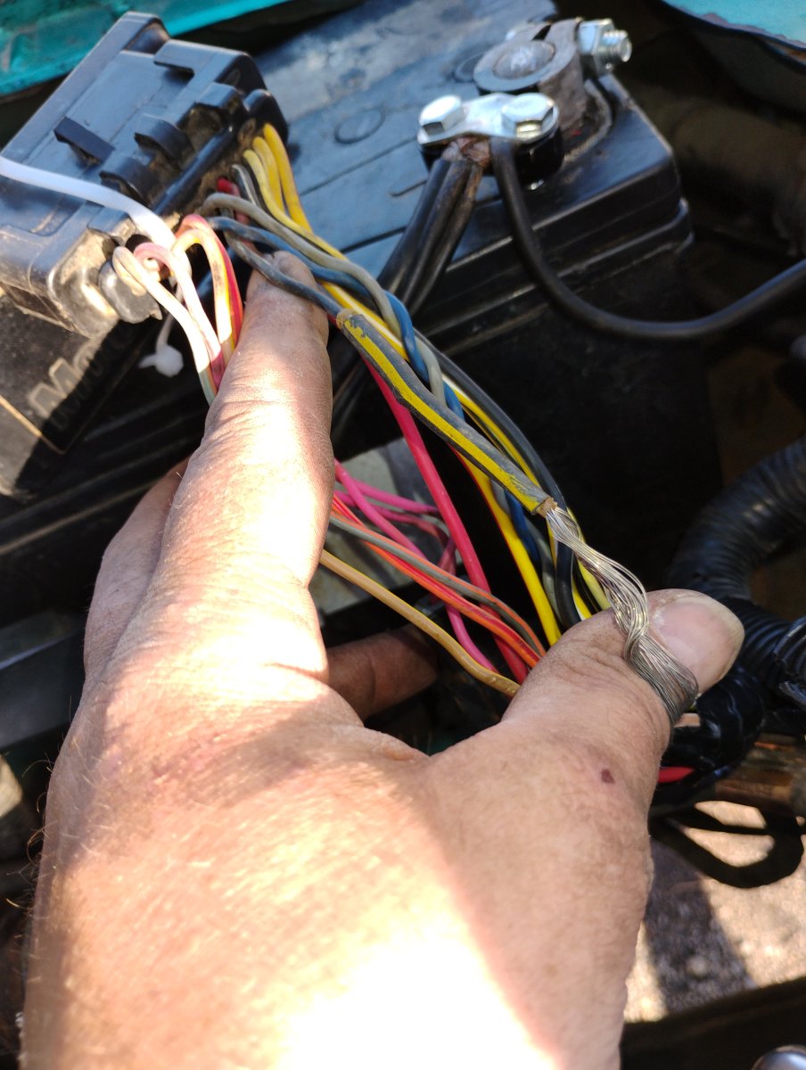

I'm sure I got a short.
From the ignition control module connector it comes out one black wire then goes into that yellow and black tube which we're believing is shrink tubing.
Then comes out it appears to be two separate bare wires.
But where do / does the OTHER end(s) of that bare wire go?
That spot that @alwaysFlOoReD pointed out does looks suspect, too.
Here is the spot on the bare wire that caught my attention:
But it's really hard to tell from still pics (even though your pics are good), versus having things in your hand and being able to move them around and look from differing angles. Your later pic, that spot looks OK, so the spot I commented on may actually be on the pink wire, not the bare wire.
This:
Looks like a probe, such as a test light, was stuck in the wire sometime past. If so, these open holes in the plastic insulation will let moisture start rotting the copper strands on the inside. You may want to look carefully at that spot. That white spot on the opposite side of the wire from my yellow arrow, sure looks like corrosion, and a hole where the probe came out of the wire.
I think that your current problem is just janky wiring.
You've got this; just be thorough, use common sense along with your EVTM, and repair any questionable spots in a workmanship-like manner.

What happened to the second picture I posted in post #515 of this thread.
This picture
Okay @alwaysFlOoReD the picture that is still in post #515 of this thread is were you asked about that pink wire with the black on it.
That you then zoomed in on and circled in post #525 of this thread.
That is the in harness Pink wire for the spout.
The black spot you circled was just some grime it rubbed right off with a little pressure.
The wire felt fine there.

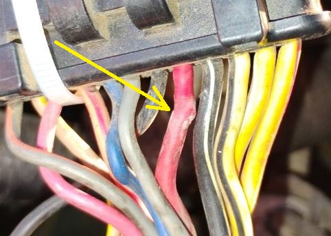

The red wire I talked about in post #523 of this thread is for sure the power wire for the ignition control module.
I realized after looking closer at it, where that spot looks funny is that way because the wire itself was coming out of the connector a little bit.
A I unhooked the connector lock that holds the wires in place and push the wire back in place.
Hook the connector lock back up. Then plugged connector back up to the ignition control module. Started the truck and had no real change in the problem I'm having.

I think that your bare wire is a ground out of the ICM which provides shielding for the signal wires from the crankshaft position sensor, and also shielding for the ignition ground to the PCM. That explains why it splits into two bare wires after the splice. This wire is at pin 7 on the ICM.
See page 21-8 in your EVTM for the ICM C176 pin-out.
If that shielding is compromised, if either of those two circuits gets too close to any source of electrical interference it can create havoc. Shielding usually has a foil wrap, around the signal wires and a bare grounding wire. Moving wiring harnesses around a little can eliminate or reduce the interference enough to make the problem go away, especially if the shielded harness is too close to other wiring harnesses, a coil pack or spark plug cable.
You may have that going on,
OR
It could be that have a basic power and/or ground issue.
Do check what's going on the pricked Red wire; that is your ignition power wire to the ICM. The Red wire is at pin 8.
And also check the Black/White at pin 9; that is the ground for the ICM. Set your multimeter to ohms (I'm sorry; set it to "headphones" :) ) and backprobe the Black/White with one lead and put the other lead on that battery negative terminal. You should read only a couple of ohms, if any, and zero would ideal.
AND
Finally, the C176 connector itself could be hopelessly pooched. I believe that you've already found and fixed a slipped (unlocked) pin on the Red wire, and the broken connector lock tab is a problem, although your tie-wrap trick should work (which I've used many times myself).
