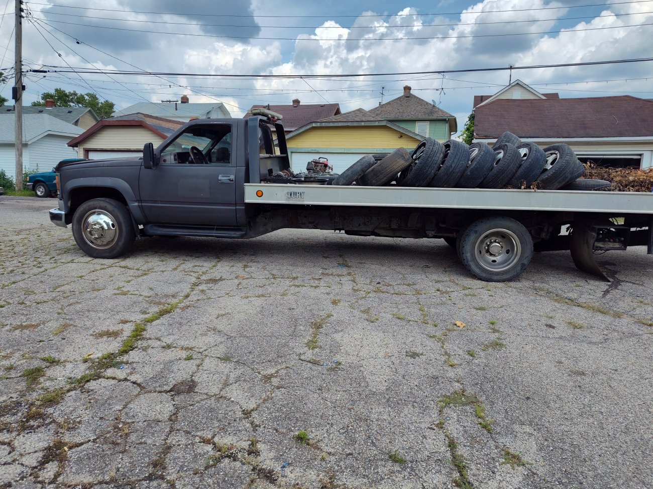

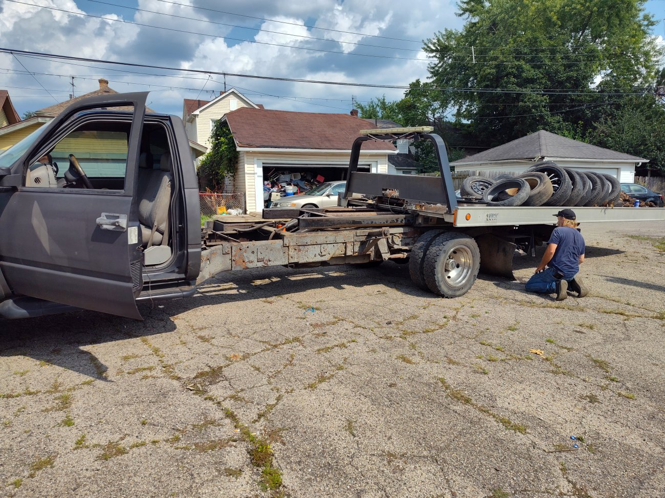

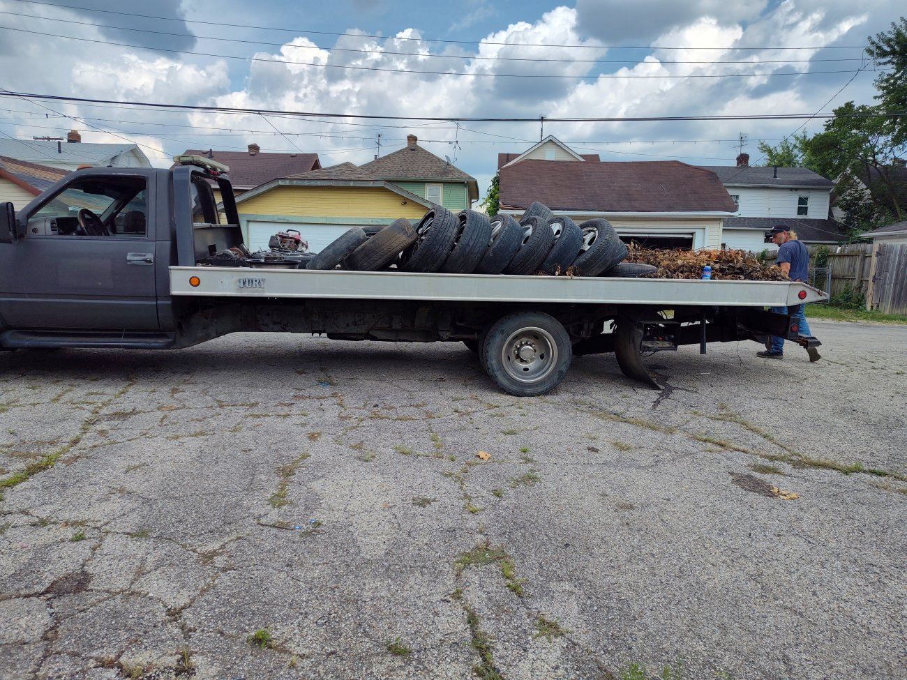

Now don't kill me you guys but the second half of my day was working on a bowtie, you know a Chevy.
Hopefully the pictures below will help you guys get over the bowtie shock.
It has a 454 in it and we're having starting problems. So I was working on it a little bit today.
The guy you sees back in the pictures is my brother Andy.
( I have 5 real brothers and a few close friends I call my brother as well. )
I was taking the pictures.
