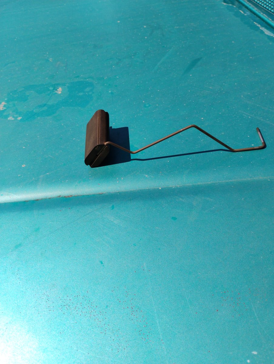

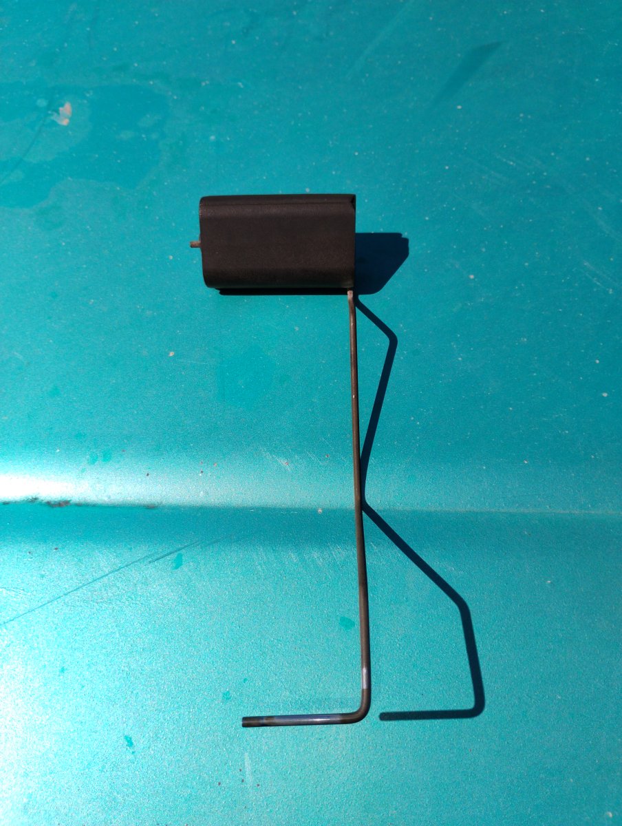

I removed the fuel pump assembly and got the float and float arm off of it.
My plan is to try to put this float onto the float arm for my sending unit.

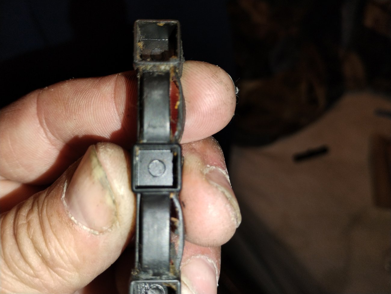

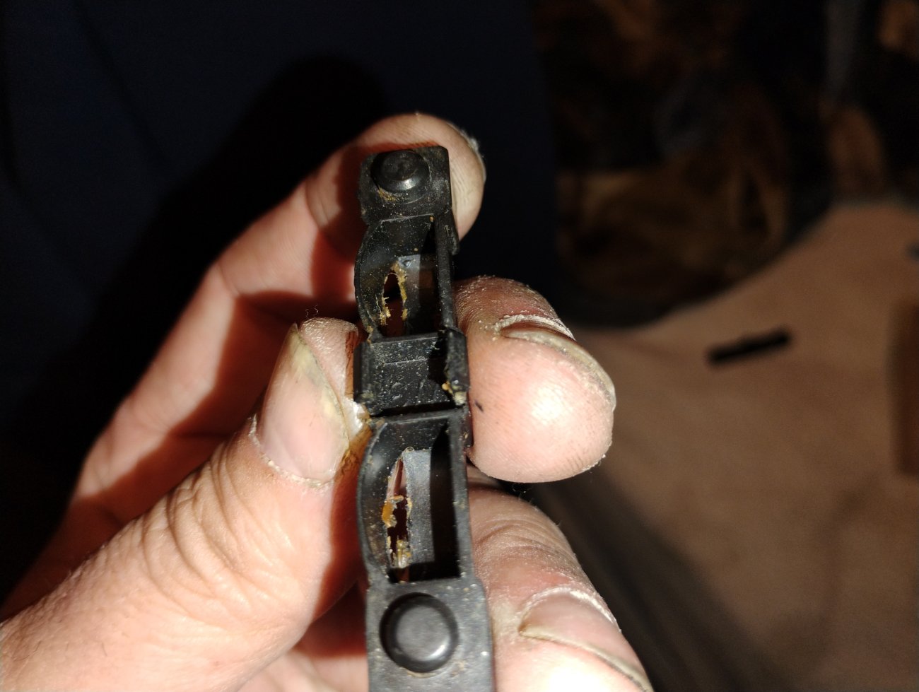

I took two small pieces from it pictures to follow.
Now can anyone tell me what they are named.
And what they are for.

Once I pulled the fuel pump assembly out I took the float arm off the sender.
Then I used my little Harbor Freight rotary tool to grind down the bent part that (I'm sure it was Bent by it being squeezed at the factory maybe even while it was hot) of the arm to get the brass washer off.
After that I used one of the drill bits in the rotary tool to drill a hole in two of the corks just in case the float didn't work.

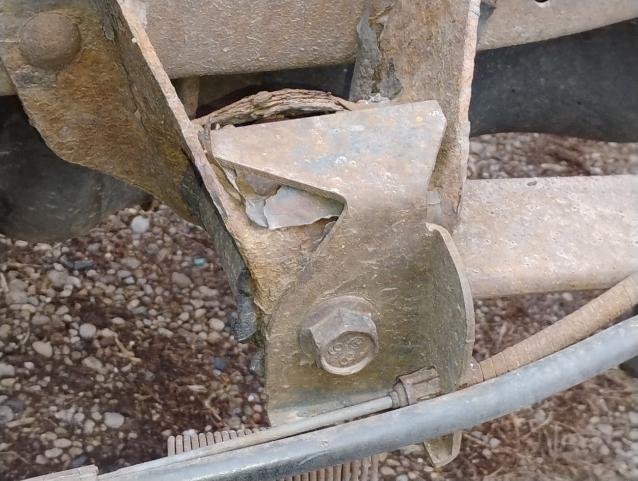

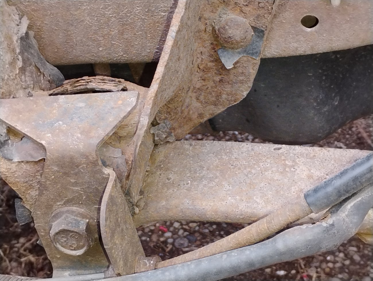

My next project I will have to pull the bed up for is the driver side front leaf spring bracket.
