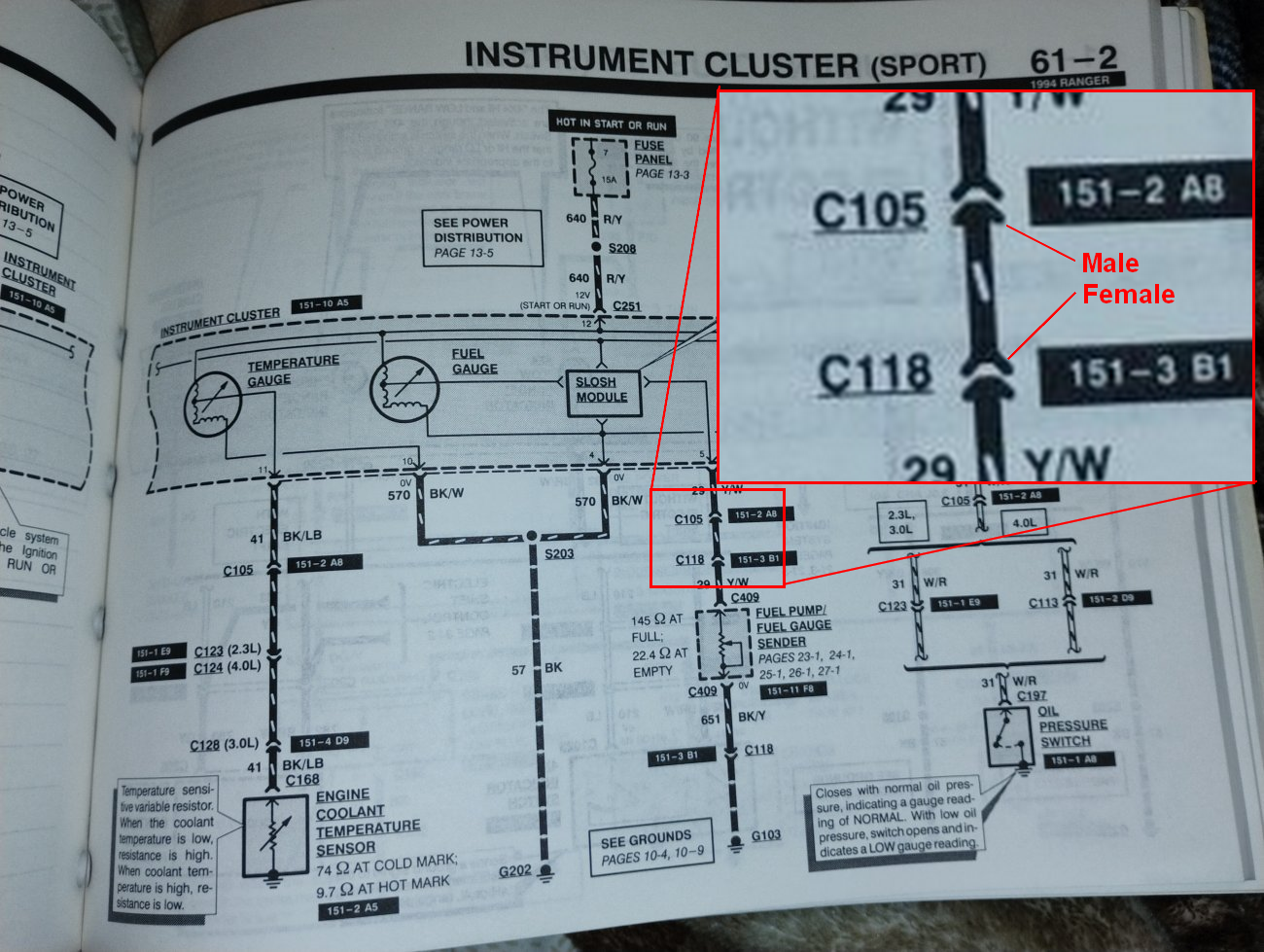

One thing the wiring diagram does (and it was in the video explaining the wiring diagram) is show the gender of the connectors. That is the best way to know. The rule of thumb is great and works most all the time, but not 100%.
For those skipped the vid here it is:
The little arrows at the connector denote gender of the connector:

that rapidly changing fuel level is basically ruled out everything but the slosh module in my mind... that is the only component that will throw out higher/lower readings that actual unless you have both an intermittent short and intermittent open at the same time. Looks like you will be re-capping / replacing your anti-slosh module to me.
