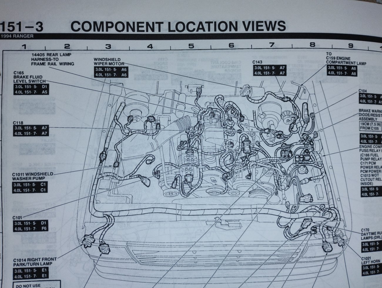

So in my EVTM on pages
61-2
I'm sure I got a short.
150-3
151-3

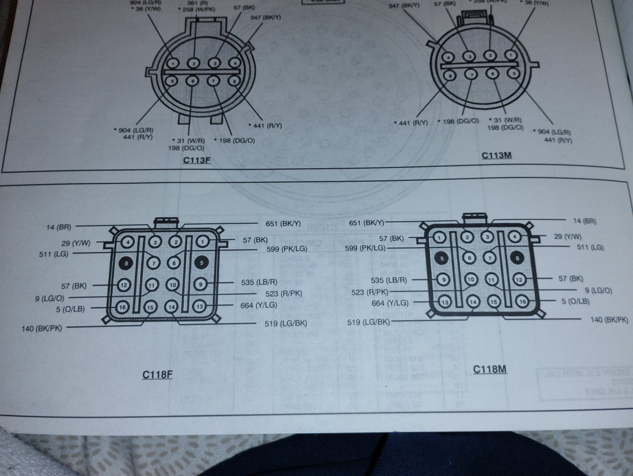

I find connector C118.
My question to you is if I disconnect that connector (C118) then put a pin in the female side at Port four wire 29Y/W. Then connect my test light alligator clip to the pin. Then touch the pic end of the test light to Port four wire 29Y/W on the male side. If my fuel pump is sending a signal towards the gas gauge. Should my test light, light up?
Or does it not send enough power throw that wire to light the light.
Am I on the right track?
Should I use my multimeter instead of the test light?
From the pic right there, it says that (wire 29 - Y/W, pin #4) is the variable ohms line from the sender, not the pump. So I would hook up a test meter set to ohms, and read the what is coming from the sender (red probe) to ground (black probe to body frame).
Not sure why the manual has the ohms range say what it does but just about all Fords are 16-160. If your tank if about half full expect a reading of roughly halfway between 16 and 160 - what ?72? if my mental math is reasonable..
To test the gauge and not the sender, when you unplug C118 the gauge (now infinite restistance) should be "past Full", if you short that pin to ground you should get "past Empty" - hold it for several second to get past the anti-slosh module's "averaging out" and the needle to change. That side needs key on during test though to have power to the cluster.
Okay now the OHMS setting is the one that has a symbol that looks like a set of headphones?
If I'm right I have the red probe pointing to the symbol in the picture right?
yup, and it looks like you meter is capable of all kinds of ranges within the umbrella ohms... set it to the lowest - 600 (2 below your probe) - since you want to be able to read 16-160 expected figures.
(Setting it to like the 6000 or 60 million makes it too numb to read usefully.)

Don't need the key on to test the sender - in fact you can test the sender on the bench / out of the truck with no power what so ever, it is a dumb variable resistor (rheostat) that changes resistance depending on the position of the float arm.
Pretty easy to figure out the correct side - the portion of wiring that goes through the firewall and into cockpit is going to be the dash end, the portion of wiring that disappears down towards the transmission running along but outside the firewall is the part that goes to your fuel sending unit.
And fwiw, you are only going to get one figure - either a good figure which is relatively close to how full your tank is (somewhere between E/16 and F/160) or a bonkers figure (less than 16, greater than 160). If you leave that hooked up and have a buddy go gorrilla trying to rock the truck enough to slosh the fuel around you might see if fluctuate - your gauge might not be fast enough to really read that though...

If it is PAST empty or PAST full - like 2 needles width gap, then it is an open or a short (which to test the gauge that is what you do - unhook the connector entirely causes an open, short pin 4 on the cluster side causes a short).

yes, unplugged it is no longer getting any resistance from sender (so infinite resistance to ground), anything above 160 ohm and it should read past full (or past empty - but referring to your picture 61-2 I think I got that correct)
