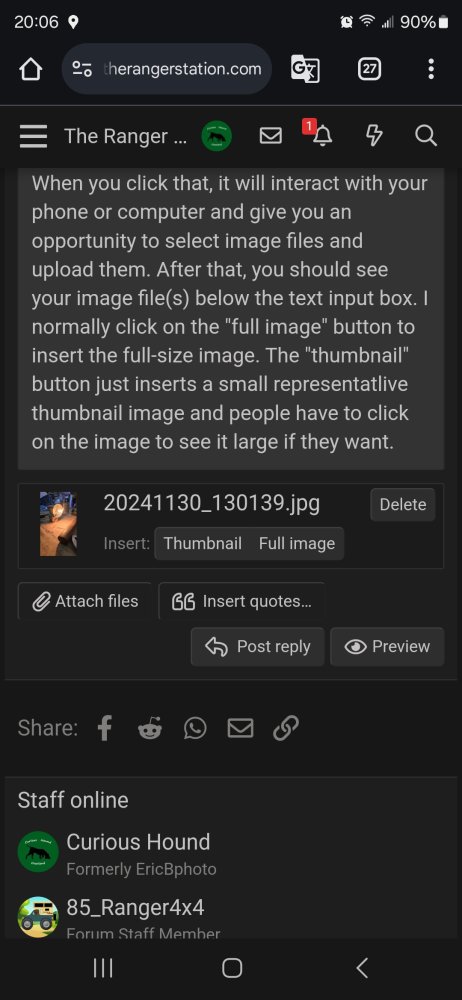

The easiest way; at the bottom left corner of the box where you type your messages, there us a button that says "attach files". When you click that, it will interact with your phone or computer and give you an opportunity to select image files and upload them. After that, you should see your image file(s) below the text input box. Like this.

I normally click on the "full image" button to insert the full-size image. The "thumbnail" button just inserts a small representatlive thumbnail image and people have to click on the image to see it large if they want.
Thumbnail;

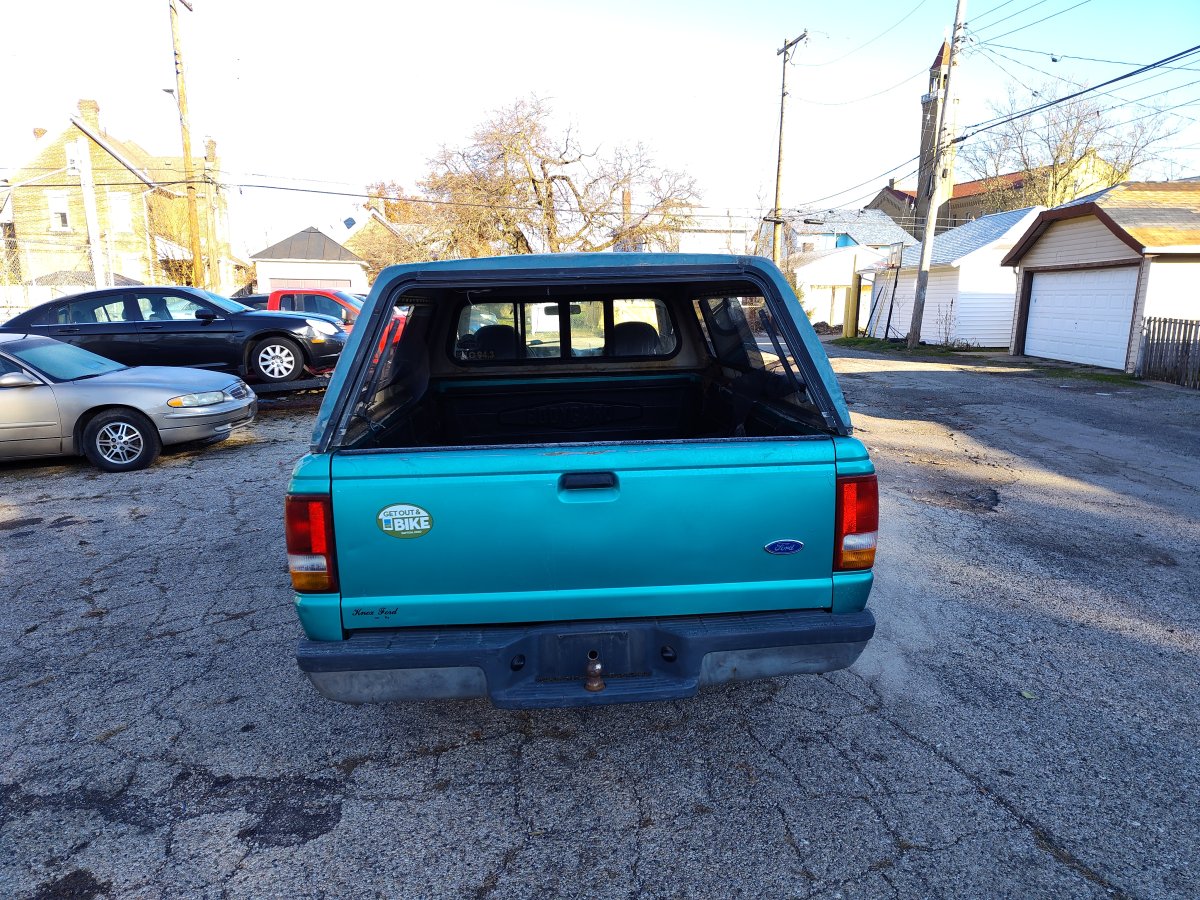

Okay guys here my truck.
I'm sure I got a short.
Okay now I don't know why it posted 2
