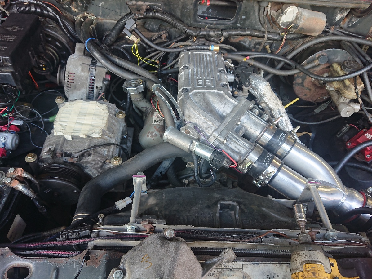

That's my 2.9 with an Eaton M62 electric clutch supercharger.
Don't waste your time with a MAF conversion. Megasquirt that 2.9.
I already did all the hard work with the help of many, especially deathbypsi), and posted the programming here for free ?
Read all of this. I already went down the path you're taking.

A Mad Max 2.9l......................................too cool :)
There wouldn't be enough coolant left in a post apocalyptic wasteland to keep a 2.9 running...
