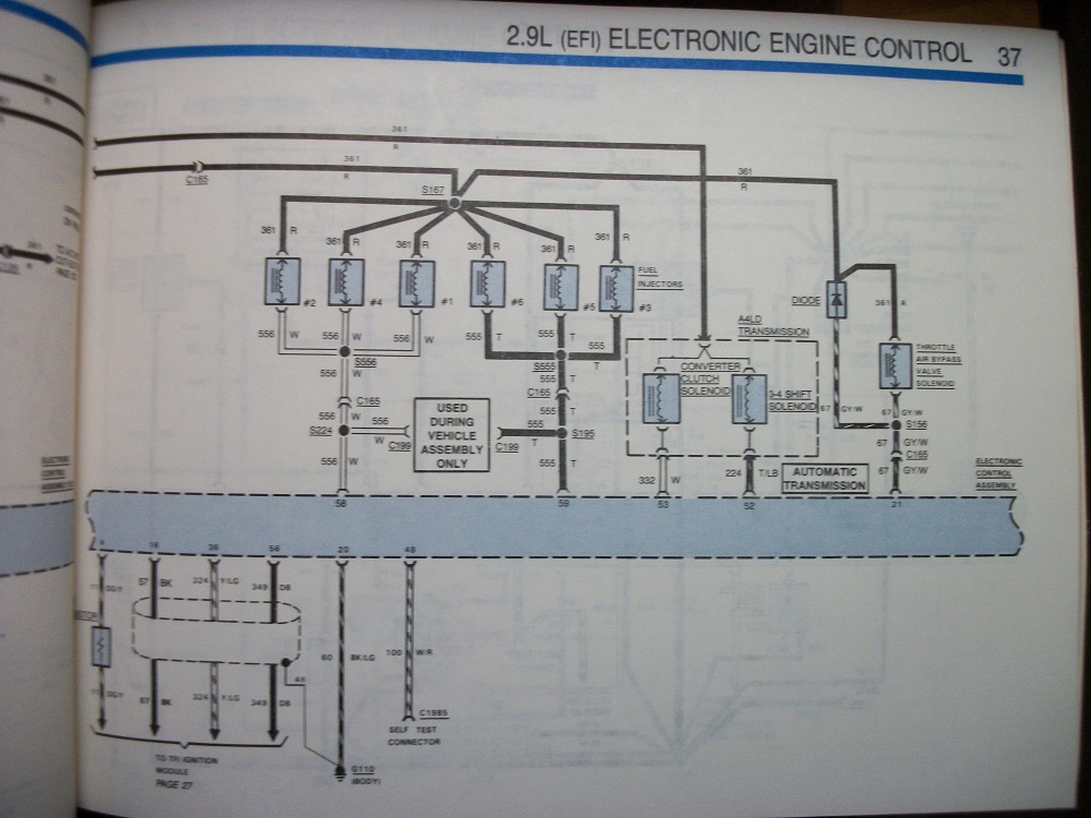

Hey gang!
This may belong in electrical, but starting here as it may be engine specific.
I’m taking the opportunity to comb through the wiring while the engine is still out, and found the ground wire for my Idle control valve to have 1.3-6 ohms from pigtail to connector.
which is kind of a smoking gun to me, but wanted to confirm that there isn’t a resistor in this rubber sleeve.
also, what is this sleeve? Is it like an inline fuse?
thanks

The '88 schematics do show a diode in the circuit, but the drawing shows the reverse of what you've pictured.
Wouldn't be the first typo I've seen in the Ford schematics, and it should be easy to confirm/check with your meter.
Basically it looks like they've put a quenching diode across the solenoid coil.
IAC Wiring
The IAC is nothing more than a coil of wire, solenoid. Whenever you energize a coil of wire and then turn it off, you get a kickback in the voltage. The diode is there to allow the voltage to continue flowing around the circuit until it dissipates when the power is turned off.
A diode does have a small amount of resistance. I would reverse your meter leads and just ensure that there is zero continuity the other direction.

To make clear about the diode in later model IAC solenoids...
If the IAC has an internal diode... the diode symbol will be cast into the IAC connector housing... as shown below.
IAC Wiring
The IAC's Ground wire is the Control wire that runs to pin 21 on the PCM(ECM)
So its not a direct ground to battery negative
Ford uses a PWM(pulse width modulation) circuit in the PCM to control IAC Valve, and that's the circuit you are reading OHMs thru
Can't say what would be correct OHMs key off, but for sure not 0 ohms, as its not a direct ground
I assumed... bad idea I know
Your resistance test should have been done with that circuit isolated. Meaning harness disconnected on BOTH ends... and reading resistance on that circuit and not to ground.
@Uncle Gump @RonD
Your assumption is correct! Harness is disconnected. Not measuring plug to negative terminal or chassis ground. I'm measuring resistance across the diode, but it's just easier to measure from the pins on the disconnected harness.
Yes, to test the ohm resistance of the complete IAC control circuit you do need to disconnect both connectors, IAC and PCM, and probe the terminals with the meter on both ends. With the harness out and on the bench that would be OK, but it's very difficult to do such a test accurately with the harness in place in the vehicle.
On the other hand, it would be relatively easy to just replace the blown diode, as it did fail in your testing, and then see how the truck does from there.
Great. Appreciate all of the wisdom, fellas.
If the diode is in fact cooked, would there be any other relays that would merit inspection? Not sure how it died, but if it was from excessive current or reverse voltage, would there be anything else on that circuit that could fry? Other than PCM? Looking through wiring diagrams, that Red 361 wire seems to touch a lot of stuff.
A voltage drop test on the Red 361 wire at the IAC, after replacing the diode, would the easiest way to tell if there's anything else that needs to be looked at on the power side.
