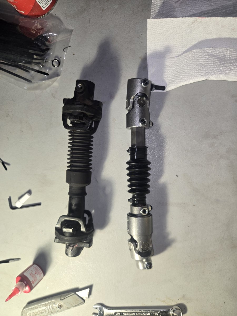

Thanks Paisano, I bit the bullet and did it. It was for sure a challenge but it paid off in the end. Took all the slop out but I still feel some coming from the steering box. (maybe that's next lol) Still feel lots of vibrations 65+ mph though. I only felt it after I put some new tires on but I think I'm gonna look at getting new bushings in the front. Other than that it's slowly coming together. Thanks for the info!
I want to assemble new intermediate steering shaft.
Thanks Paisano, I bit the bullet and did it. It was for sure a challenge but it paid off in the end. Took all the slop out but I still feel some coming from the steering box. (maybe that's next lol) Still feel lots of vibrations 65+ mph though. I only felt it after I put some new tires on but I think I'm gonna look at getting new bushings in the front. Other than that it's slowly coming together. Thanks for the info! View attachment 139362
Looks good
Update:

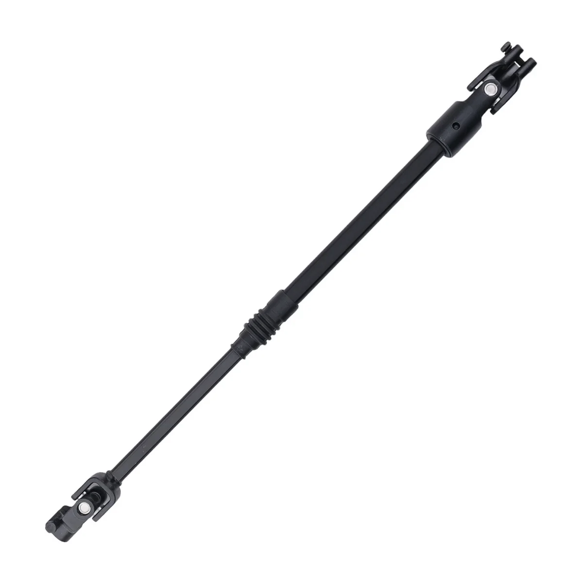

Finally got this done last weekend. I did end up using a 1” DD X 1”DD & a 3/4” DD x 36 spline anti-vib with the Jegs 3/4” x 1” telescoping shaft. So Paisano definitely saved the day with the 1”x1” info. Thanks everyone for the information, feels a lot better with all that slop out of the shaft!

How much did you have to cut down that JEGS shaft? And why, or do, you need a telescoping shaft? For background, I have the engine and transmission out of my 91 ranger, and I want to upgrade the steering shaft while I have easy access. TIA!
Hello G.
Sorry I didn't respond earlier. I have not been on this site for awhile.
Yes. I needed a telescoping steering shaft for my 92' Ford Ranger XLT with 2.9 V6.
As I recall, I don't think I could find a fixed length shaft for mine.
I don't remember how much of the shaft I had to cut down. But it was significant.
What I do remember, I had to cut it down a little at a time......very.....very carefully. It took me a few hours just to cut it down.
If I cut off too much.....the telescoping shaft would be ruined and I would have needed to buy another one
