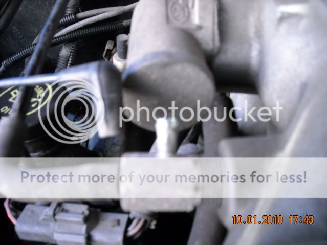

Here's the thing I don't know what it is.
I can take this vacuum line off and it revs up and settles down and runs smooth.

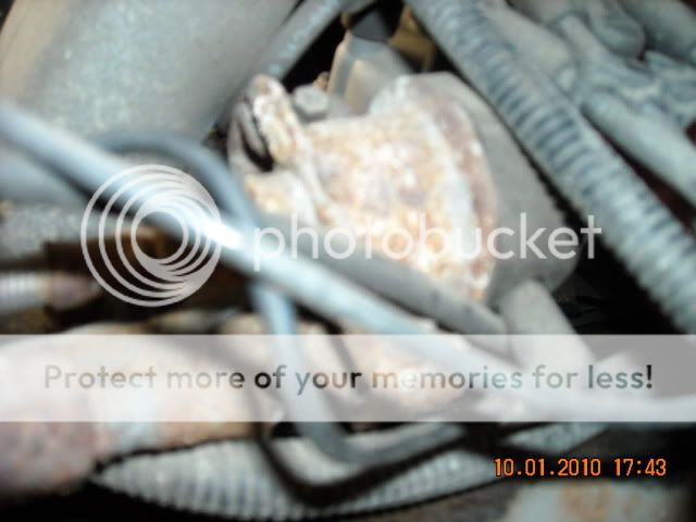

This is your fuel pressure regulator. Make sure that the little hose going in the back of it has a good connection.

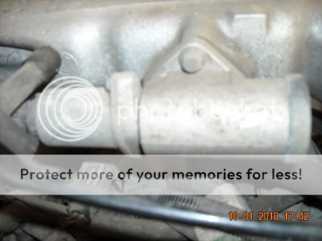

Here's something else that I might need to check.
This guy is your Idle Air Controller or IAC. Pop that joker off and clean it with your $10 MAF Cleaner.

Finally have something constructive! Thanx WTF!!! Can either of these have anything to do with a rough idle at startup?
This mo-fo is just a vacuum fitting with two lines. Take a hose off of it and it'll mess with the timing advance since the end nipple is connected to the Manifold Absolute Pressure sensor or MAP sensor mounted on your firewall. The other hose goes to the air filter box.:beer:

Yes, these 2.9s are touchy when it comes to timing, spark, and being fed good oil. Make sure that you do your homework in the Tech pages here and read anything to with the basics or tuning. You'll be glad you did.:beer:
MAP? Follow the big hose to the end and there is the MAP? Could it cause a rough idle start up? Also, my exhaust manifold has a crack near the #4 cylinder. Could that cause a rough idle? And as a temp fix....JB Weld the crack?
Anybody else chime in if I'm way off but.....yes, the MAP will hinder the idle-redline rpms since our trucks use a "speed density" method to regulate how fuel and timing advance are applied.:beer:
Finally!!! I took the IAC off and cleaned it with my $10 can of cleaner and started the ole rust bucket and it idles perfect. Anyone with idle probs should do that first. Took maybe 10 minutes. Thanks Guys for all your help!
