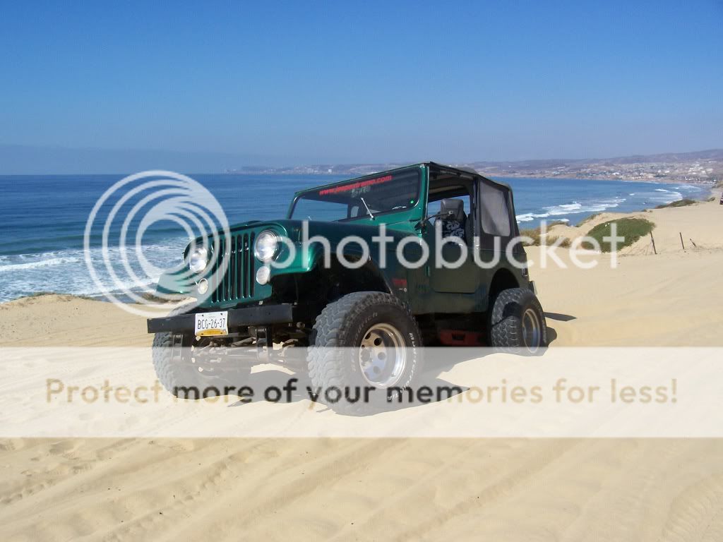

look this is my baby
cj7 body with chassis,of yj,ax15 tranny,and the piece of s hit dana 30 and 35 with 4.11 gears,and the crap 4.2 engine
the new old axles is a ford 9 big bearing with 4.11 and dana 44 high pinion from 79 bronco :icon_hornsup:,all the wire harness from xj,head,and ecm,headers for 4.0(jeep of course)and thinking in a stroker 4.5 lts
