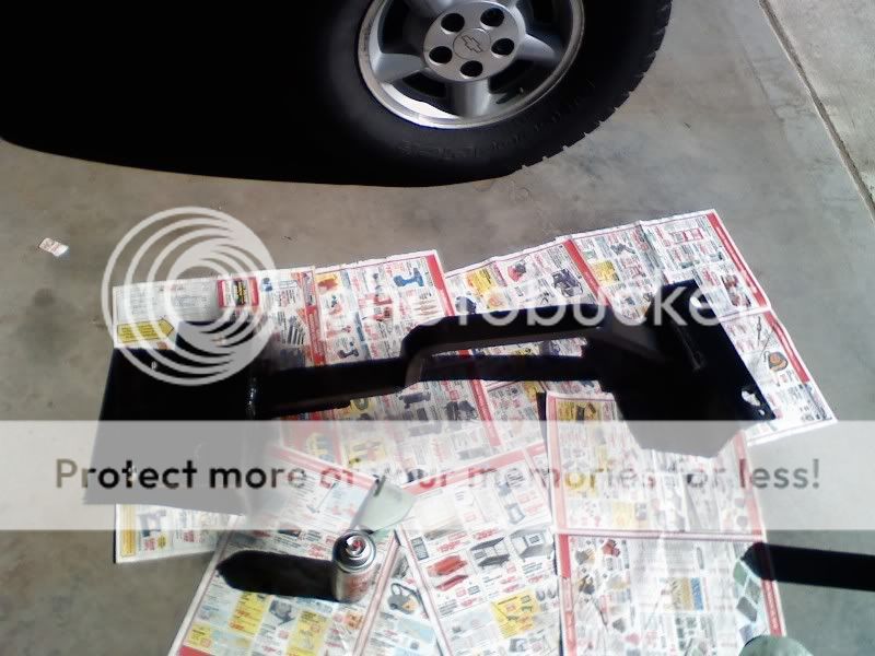

I don't exactly have all the free time in the world to dedicate to this thing.When i do get to work on it,it's usually measuring something or seeing if this fits or that fits and that doesn't get a whole lot accomplished.But I do have an update.The doesn't need to be stretched so for the mean time it's not gonna be.The cross-member is finally fvcking done.It took a while but i had to build it off the vehicle which is at my house and the shop with all the tools is 20 minutes away.So i wanted to make sure everything was spot on before i went ahead and built it.And it it.before anyone asks,yes that is one inch solid steel,yes i'm trimming down the right angle.No i didn't heat it to bend it I used a forklift.And yes I know the holes are huge.I'm gonna weld em shut where they shouldn't be open.
