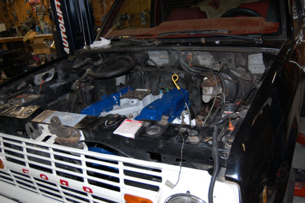

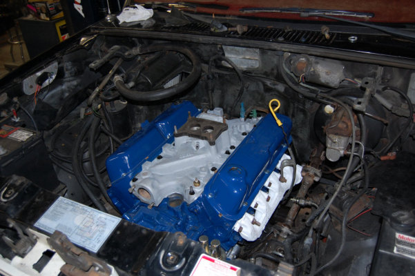

Here's a couple pics of the engine planted:
  • I fought all day and lost . . .
