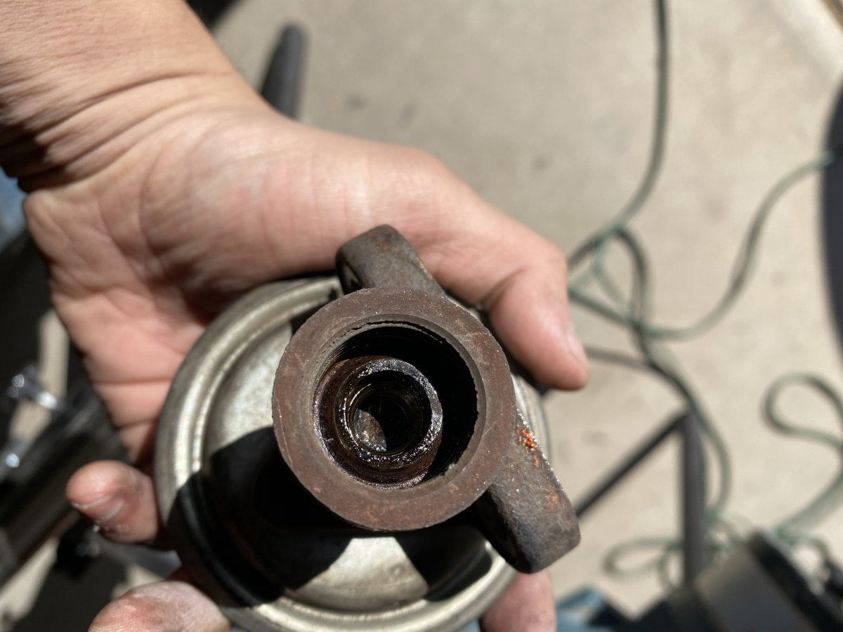

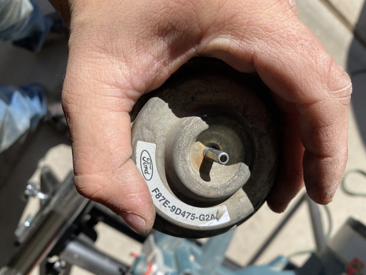

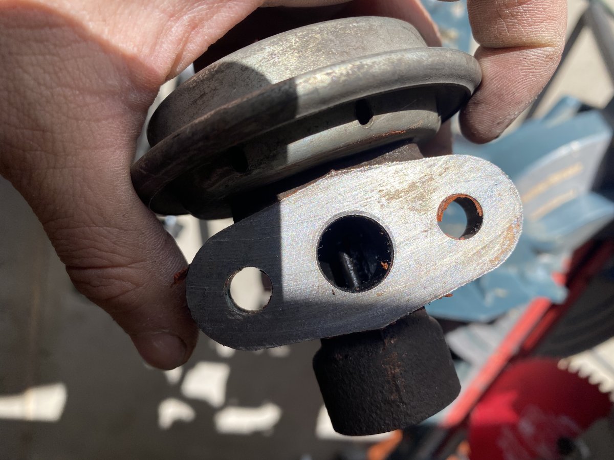

I took the egr off, cleaned it with carb cleaner, sprayed the exhaust tube and put a foot of steel braided wire on a drill and cleaned it , put it back with a gasket after soaking the egr valve and internal with carb cleaner, the egr valve had a strong spring and seemed to work. I took my maf apart and cleaned it with maf cleaner. I cleaned iac and dpfe terminals . Now the only code left is p1504 and the two 172 and 175 codes . code 1401 and 1132 disappeared

IAC valve is unrelated
What Brand is the IAC Valve?
Test for exhaust blockage using a vacuum gauge
Partially blocked exhaust would explain these codes, you would also have a loss of power at higher RPMs
P1401 DPFE (egr valve sensor)
P1132 lack of upstream HO2s
P0172 rich bank 1
P0175 rich bank 2
Get a long vacuum hose, and remove current vacuum hose from EGR Valve and attach longer hose to the EGR valve
Start engine
Use finger to see if removed EGR vacuum hose has vacuum present, it shouldn't, EGR Valve is only used after engine is warmed up and when RPMs/engine load is higher than idle
If there is vacuum on the hose then EGR solenoid is leaking, replace it
Suck on the longer vacuum hose, engine should start to stumble as exhaust gases come in thru EGR valve, release suction, stumbling should stop
Repeat until you are satisfied EGR valve is opening and closing as it should
Yes, if EGR valve is leaking exhaust gases into the engine when closed it could cause these codes
