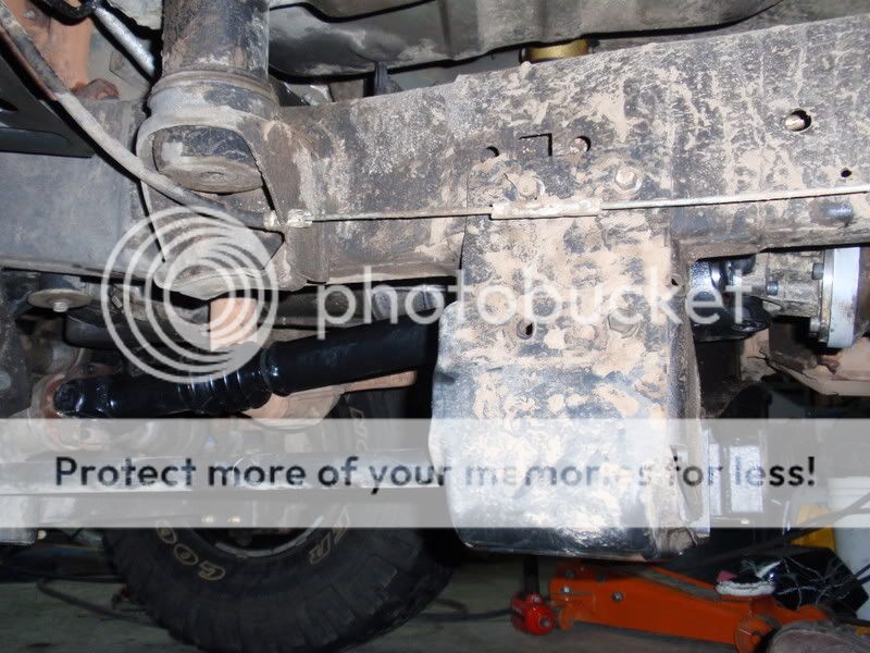

Here's a little pic for ya....
Half way into the doors and under the frame, you'll see the T-bars. A 1.25" bar or so hangin under your truck. If you can't find 'em, you either don't have T-bars or you are blind!!!
