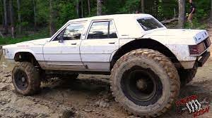

I'm no 4wd expert ( I know, hard to believe ), but from what I've learned here, is that the front gears have to match the rear gears to keep things from binding up and/or breaking.
Can you guys explain what I'm seeing here and how it works. I saw this on DeathWish S2 : Mud Buggy Adventures. ( Prime )
The simplest answer would be to match the differential gears to the tire size at each end so everything evens out. So lower gears in the rear axle with the larger tires, vice versa up front.
Miss matched tire sizes require miss matched gear sets.
You probably wouldn't want to drive it to town... but to sling mud/sand it works.
This^^^. As long as it is geared so both tires travel the same distance per revolution of the driveshaft, you are good.

Kinda what I thought, but wanted to ask the experts.

They probably put the Marquis on a tractor setup. It has a nice big diesel engine where the center console should be...
