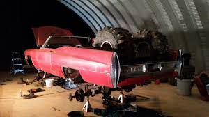

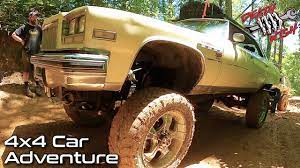

Is the marquis actually four wheel drive? That would be the easiest answer.
Yes. Watching the show, you can see the front tires spinning independently and at different speeds from the rear ( fronts spinning while rears were rolling slowly)
The only 2wd car, and that's because something broke up front.
It sounds like they where setup with the same gears then, just hope the fronts spin enough to keep stuff from binding up. Seems like it defeats the purpose.

Option 2 is a transfer case with a differential in it e.g. np203 or 242. The differential in the transfer case allowing for differences in tire size.
Differential open on the street, then lock it when you are bogging.​
