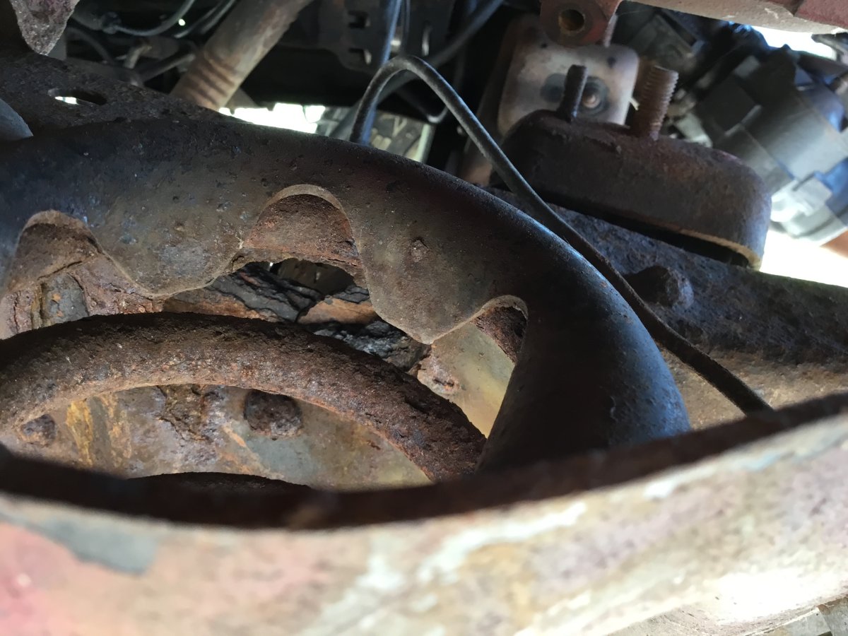

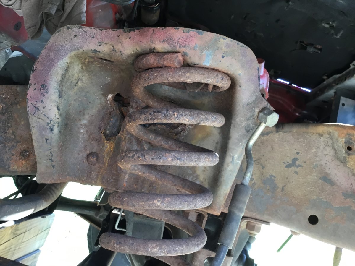

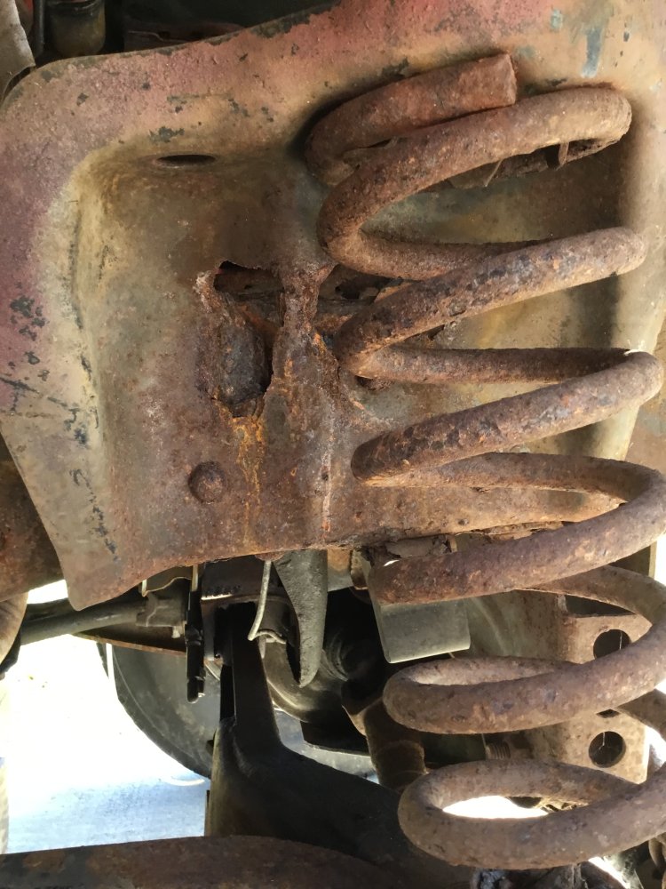

long sad story: Five years ago I got this Ranger and instantly I was in love with it. Shortly after I got it, it started to overheat. I brought it to a local NAPA and the owner started replacing parts instead of diagnosing (heck, I didn’t know the guy was a shyster. When he said something needed to be replaced I was like OK.He said it would fix the problem) So finally he told me he had it fixed and I got it home and it was still overheating and now it was dumping transmission fluid everywhere. So the guy got me good for about 1500 bucks and i never went back. My friend told me that she could help me do it so OK, I know my way around a wrench some. so long story sadder, we took the whole engine apart, took the whole transmission part, it’s all in boxes for 2+ years and I finally got it back into my yard. there was a lot of rust in the cab because the person before me had a leak and didn’t take care of it really rusted out the driver side floor all the way under the seat and I’ve already got a 97 Ranger lined up to cut the whole drivers side bottom out to replace mine. My issue is at is time that the assembly that attaches the wheel hub to the body needs to be cut out and replaced. I don’t know what the hell the name of this piece is (I do have the replacement for it which was bought couple years agoj I just need a little bit of guidance since I don’t wanna go under there willy-nilly and do more damage than I’m trying to fix. I gather I need to grind off the rivets, then knock out the back end of them, (I don’t even know if it’s really attached with the old weld anymore). then clean it up and grind the powder coat off of the new part to get it all prepared for the welder. I’ll post a picture of what I’m talking about. I looked for quite a long time on the web to see if I can find the name of this part so I didn’t look like an idiot on this forum but that’s the way it goes. I’m a newbie and I just don’t know. I do have a Haynes manual but it’s at my friend‘s house and I have to use that term loosely right now. I’m going to get another one. Any guidance would be greatly appreciated. Thanks a lot.

Spring bucket. Yes grind off the rivets, knock em out of the hole, drill the holes to larger 1/2” and bolt the new ones on with grade 8 hardware.
If you have the entire 97 truck for parts and both trucks are 2wd or both 4wd, consider putting the spindle/ knuckle/ and entire front brake system on your 87. That is a great upgrade to dual piston calipers and getting rid of the bar style caliper mounts. The spindle and hub assembly should bolt on with no issues.
If ithey are both 4wd, take some time and put the d35 front end from the 97 on your truck. If gear ratios are different. Grab the rear axle as well.
Welcome to the site. More pictures of the truck please. :)
I hate to be the bearer of bad news, but when you remove that part/spring bucket , you will find massive rust damage to the frame.
before you start removing stuff, get a hammer and start banging on the frame in that area to see how much of it falls off. then reevaluate your plans.

So like has been said, that’s the coil bucket. I’ve replaced them, just drill the holes to 1/2” and bolt with grade 8, no welding required. The frame may or may not be badly rusted behind it, so far the ones I’ve done were not bad enough to warrant repair/replacement, but I have taken to putting marine grease between the parts and filling the one pocket with grease to limit further rusting. The upgrade of course is to weld on a mount to replace the coil with a coil over shock, but since you already have the bracket and plenty of other things to work on, I probably wouldn’t worry too much.
