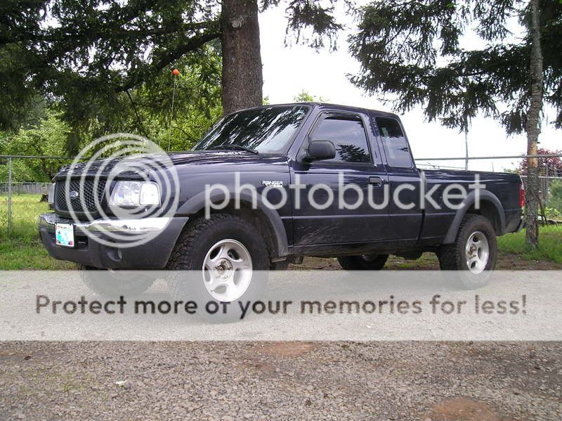

EFF IT....everyone likes pics! I'll clutter the thread with half worn 265's on my barely cranked truck...
