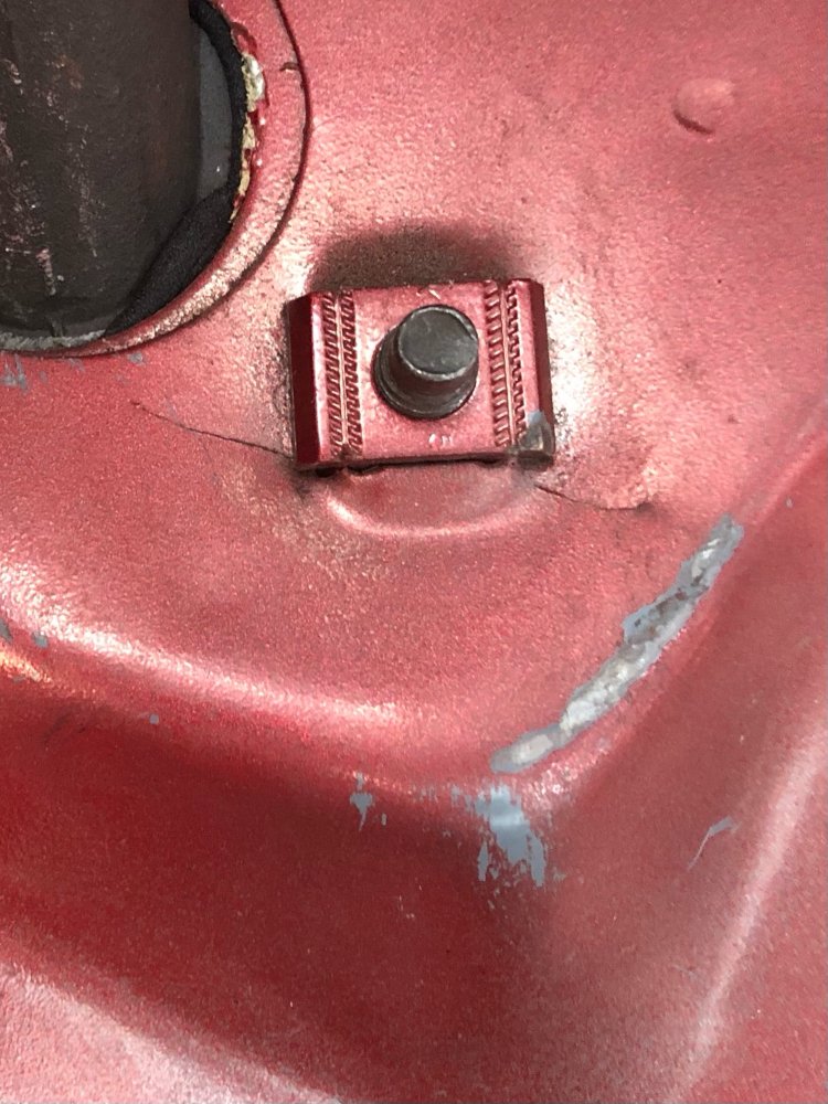

The force needed to push my clutch in is significant. So much so, I stressed the firewall to the point of cracking at the Clutch Master Cylinder mounting bolt. My truck was original Automatic which I converted over to MT using all new parts about 12 months ago (approx 12k miles). Im surprised it failed so quickly since the firewall has never had a clutch MC mounted to it and I used all new parts specific for my year and engine size. The fact that a crack developed in the firewall so soon tells me the forces are higher-than-normal. What can I do to get a softer clutch pedal? Ive already accepted the fact that I will probably need to replace MC, Slave, and clutch (which are all new). Looking for recommendations on what parts have worked for others.
pivot point.
its common though for those cracks.
I still plan to repair this by either welding or bolting a brace on the backside to strengthen. The trick would be to do it so it doesn't reduce the pedal throw.

I beefed up the crack with a rigid brace on the backside so I stopped any flex in the firewall.

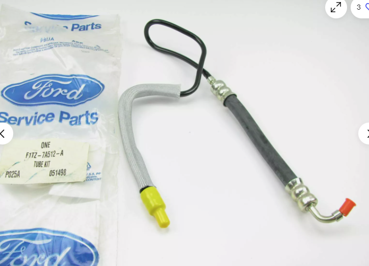

The above symptoms would indicate air in the hydraulics but I had it performing perfectly for a year with a fraction of the bleeding effort. At this point I suspect either the slave cylinder went bad after beating on it hard for a year or I still have some air in the Ford OEM clutch line (which has a section of rubber hose in it). Ive never seen a line like this before so it makes me wonder if ford discontinued them....
That's definitely weird. I've never seen a line like that. Both of the ones I have are just nylon or whatever the whole way.
I have never seen this before either and if you think about it, it may be my issue. The rubber hose section of this line probably adds volume to the system compared to the 100% nylon lines or even the aftermarket braided steel lines. The reason I went for an OEM line is because the cheap after market one I installed previous to this blew out of the slave connection while driving to work one morning. Cost me a tow home.
Im going to pick up another aftermarket clutch line and try that before dropping my tranny. Any recommendations on brand/part# to look for? Are the stainless steel braided types better than the nylon lines?

I've seen worn discs and defective pressure plates both cause the symptoms you're describing. In both Rangers and F trucks that vintage we saw cracks around the clutch master, especially if the owner ignored the hard pedal for a while. Ford used to offer a bolt in firewall brace but the stiff clutch still needed to be fixed.

As far as my dragging clutch problem, I believe the cause is the OEM clutch line I recently installed. My guess is that this line added additional volume to the hydraulic system resulting in a reduced throw of the slave cylinder which is causing my clutch to drag and make it difficult for me to switch gears. I've only used the "stock" nylon types which work good but have a lot of bends in them and I would think are susceptible to heat off the exhaust pipe. I'm leaning toward using an an3 type as suggested by Mechrick. These I think would be easier to bleed as well. Again, any recommendations on which brand to buy/not buy would be appreciated. If I don't hear back I figure I will go with this one:

I have to agree with you on this given a perfectly rigid line. But the OEM part I have currently installed has a flexible rubber section in it. Not sure why Ford did that, maybe to give a more springy feel to the pedal? I think at this point I'm going to change out the line regardless to see if it changes or not before I drop the tranny again. argh
