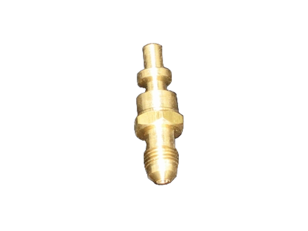

The Russell fittings. I used another on the slave end, I welded it to the original stub that fits the slave. See:

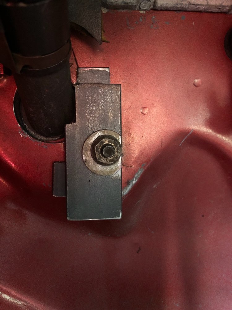

Over the weekend I braced the MC mounting from the inside by running a longer mounting through the lower hole, then bolting in a metal bracket. This should prevent the firewall crack from propagating.
The plates sticking out from underneath are needed to bridge the gap caused by the factory nut welded to the firewall. Just need to be trimmed. Clutch pedal comes close to interfering with the added brace so may need to come up with another solution if it ends up being a problem while driving.
the t56 long unit may be a way to get onto the ranger slave....chuck it in the drill or drill press and flapper wheel the first part of the flats off.
