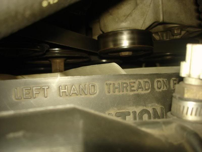

Well, I beleive it is left hand thread. It should say on the top of the fan shroud. The tool that is used to remove the fan has a holding fixture that uses the water pump pulley bolts.

Yup, some are left and some are right. I can't remember which ones are which. What I do know is that if it is left hand it says so on top of the fan shroud.

I can't remember if mine is right of left hand threaded, but I know it says it on the shroud. I rented the tools from Autozone, and they were so damn mangled I just ordered a brand new set. I'd try and get a brand new set.
