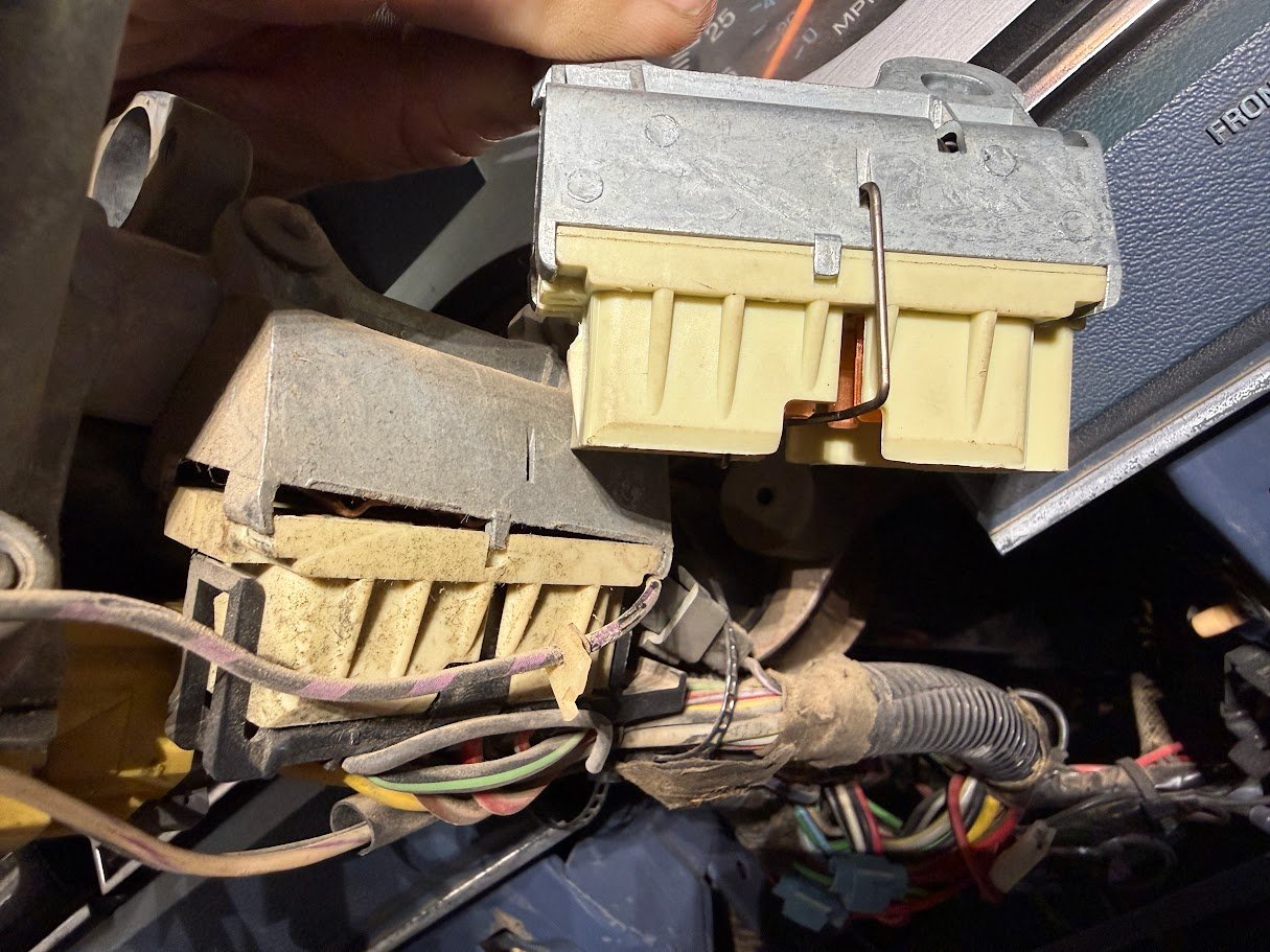

New vs old switches - note where the old one is spread apart. That metal clip on the new one serves no purpose, I cannot ever get it in place so don't plan on using it.

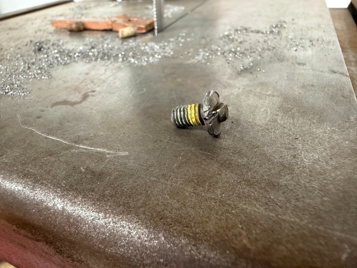

These are the factory anti-theft bolts:

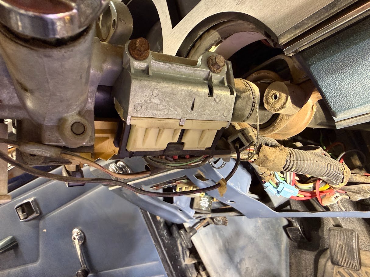

This is a pic of how I routed a tie-wrap, just to get by until I could do a proper switch replacement, but never got around to it. It's still working fine zip-tied together, 15 years later now, so I just run it.
(please feel free to use the pic).
