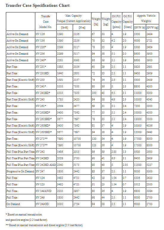

If you look at the NP transfer case chart, they are using a "load factor" of 2.2. Justification - even with flywheel/flex plate & torque converter, peak torque is higher than average torque and it is average torque which dyno measure. And if the drive train part can't handle the peak, in case of transmission, clutches slip, and once they start slipping, it is downhill.

My T-case concern is eased a bit by the fact that the lightest case in that spec sheet if rated for 1,590ftlbs! I too am concerned for the front axle, but with the Dana 28 the front only get's 33.3% of the torque and I will only use the clutch for very slippery slow conditions. I have also found better friction plates/clutches for the 5R55e and I can tune to raise the line pressure for firmer engagements to save the tranny. If I rebuild the tranny, I might as well go with a better torque converter too.
