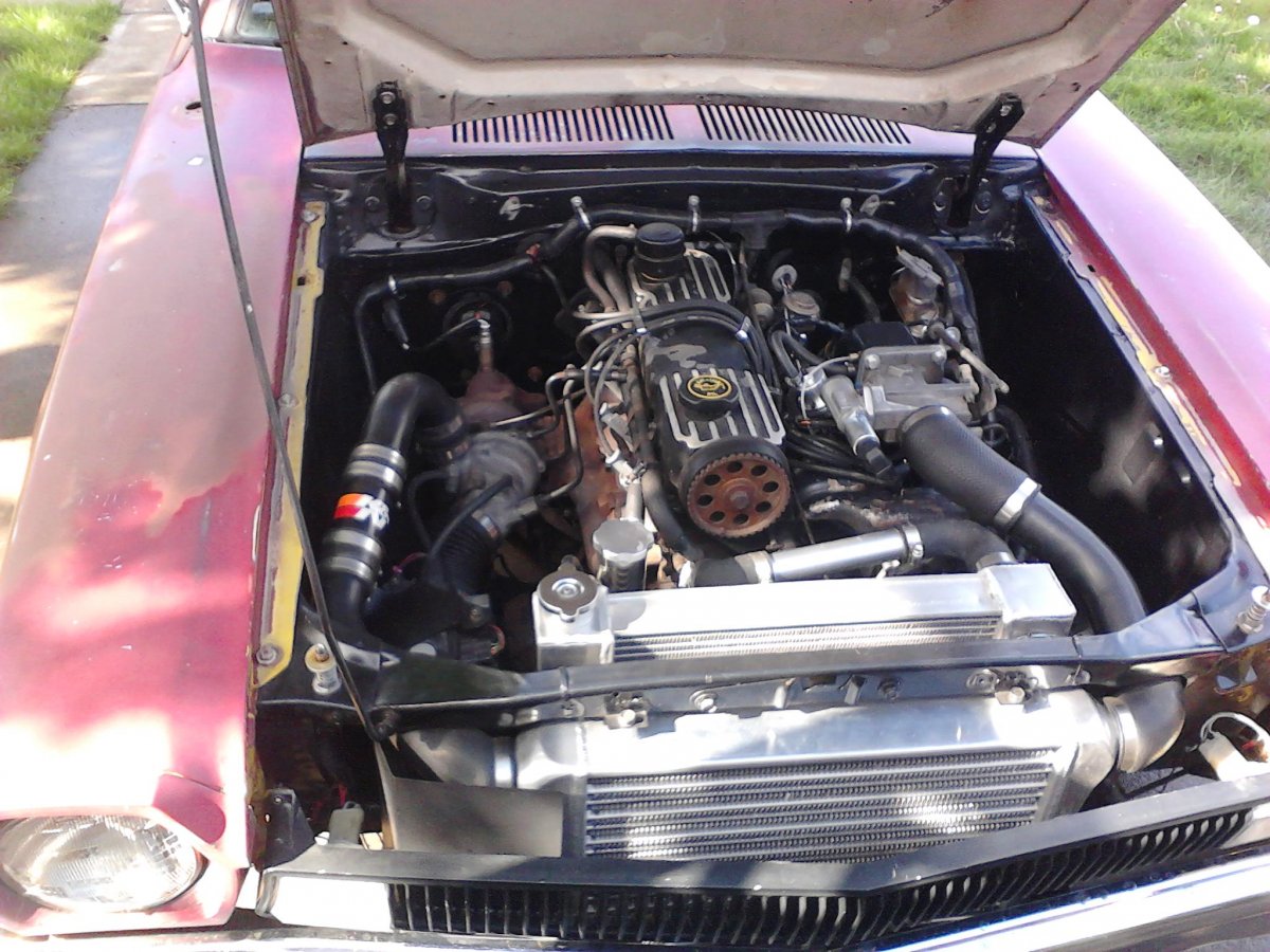

I have run as high as 25lbs of boost, on 2.3t, with about 100 octane, and
a good tune.
