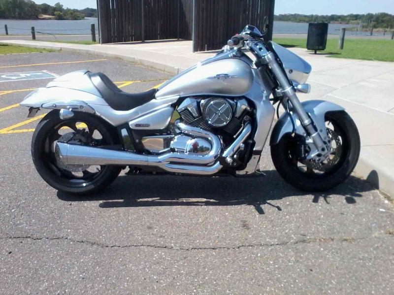

Too funny. one day at work, some knucklehead decided to sit on my 2006 Suzuki M109R, without asking me. He then said ouch, when he burned his leg on the two-into-one header. "Why is that so hot/" DUH!! :threadjacked:

Too funny. one day at work, some knucklehead decided to sit on my 2006 Suzuki M109R, without asking me. He then said ouch, when he burned his leg on the two-into-one header. "Why is that so hot/" DUH!! :threadjacked:View attachment 91848
