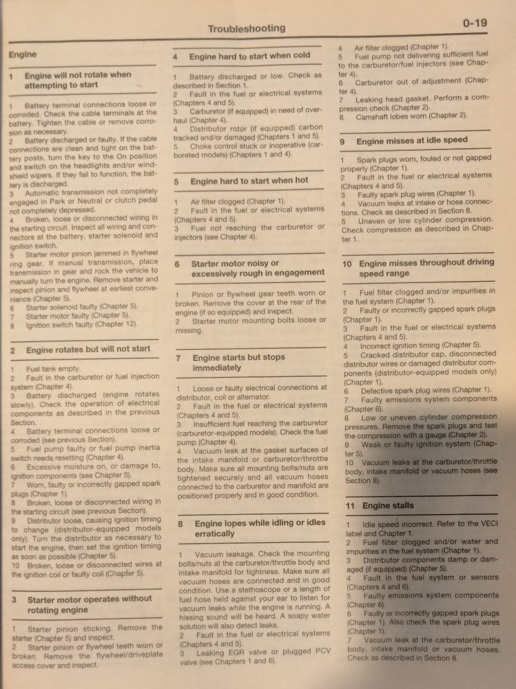

Haynes has little on fire system for no start hot, it is mostly fuel.... (#5)
