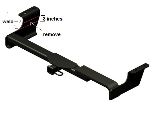

i can't find the pics, but basically, you just chop 3" off of both sides of the hitch, what i would do is take the plate that is shaped lika a J and goes up to the frame, cut it straight across level with the top of the J...
screw it i'll ms paint what i'm talking about, this hitch is not from the ranger, it's about as close as i can find though... like i said earlier, i would get a licensed welding shop to weld this, if you ever plan to tow on the street, if it's just for recoveries off road or towing on a farm, do it yourself (if you can weld)
I can weld pretty good now but I think I will have a shop do it just for good measures.Just to be on the safe side.
honestly, it's not a safety issue, it's a legality issue, if that weld breaks, the person who welded it is liable, if it's a licensed welder, he will have insurance for that... and even if something else breaks they could say you made modifications to your hitch, you must have made modifications to something else to cause it to break

Well if this is a legality issue then I will have a shop do it. plus I just dont trust myself enough to do it,and have it take a dump while i'm goin down the road.
