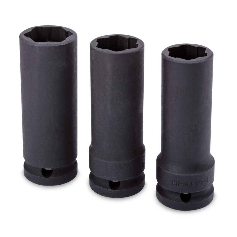

How do you break off a lug nut that’s been rounded and cross threaded? Asking for a friend that apparently can’t use air tools
If it's that screwed up, I think I would jump straight to drilling the stud out of the center. Thn lug nut falls off. Remove the wheel. Replace stud.
Yeah… thanks man. It has to go to a shop for that, so to get through our work day I just plugged the tire and aired it up. We don’t take this truck out on the hwy anyways.
use a damaged lug nut removal socket... about $20

I've seen many aluminum wheels damaged by guys trying to cut off lug nuts, don't do it. The sockets posted above or one sold to remove wheel locks would be the way to go. You need an impact wrench to use the lock removal socket.
