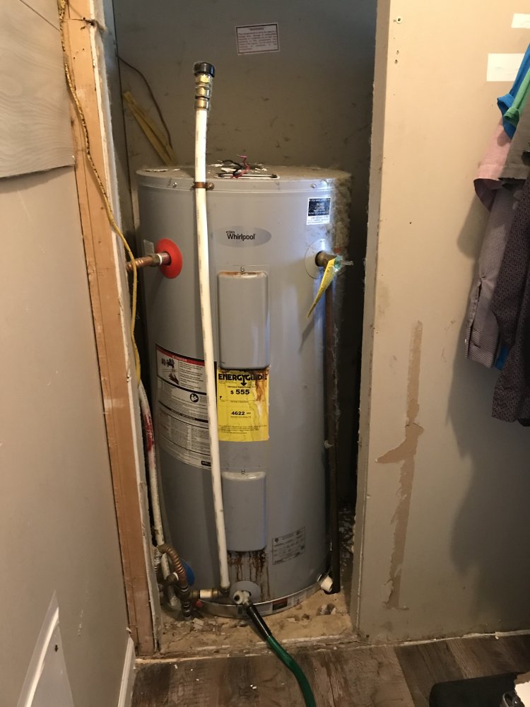

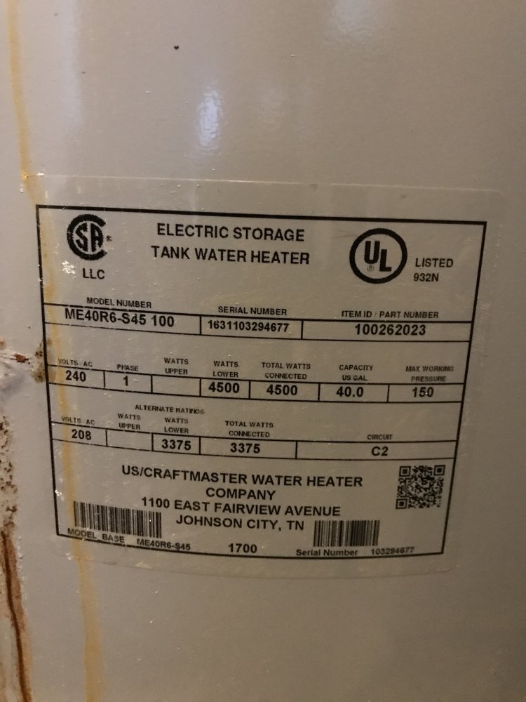

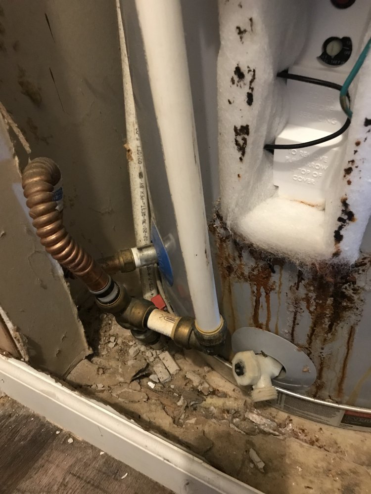

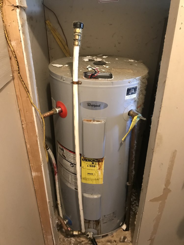

Well it looks like its time for the dreaded job of changing out the hot water heater. I knew from the looks of the outside of it that it was on borrowed time when we moved here last fall, seems to be electrical rather than ruptured but given the signs of slight leakage at the thermostat covers Im going with a whole new unit. What odd is 2 things: The in/out (cold/hot) hookups are on the side, and theres some sort of pressure valve on the cold side. It does also have the conventional pressure relief valve on tank exiting through floor. Its a electric tank, 40 gallon on well water, there is a softener so I don’t understand the corrosion, this tank was new 5 years ago according to the previous owners. Im thinking of going to a conventional top hookup instead of this side crap, Not sure if I can axe that valve on cold side. There is no pressure tank like Ive seen on most well systems. Tank is draining right now. heres some photos of it.

The side plumbing connections are used for mobile home water heaters. Should be no problem changing to a top connection unit.
I'm not sure what what the doodad is on the cold line. Some units will have a thermal expansion tank but that doesn't look like one.

See about putting a shut off valve on the supply side. It saves having to turn off the entire house if there is a need to work on the heater again.

There is a shut off on supply line, right as it comes through the floor. I would add one if it didn’t. Still draining. Takes forever going through a garden hose gravity feed into the yard. The drain pan under the water heater is barely bigger than the base of the water heater, seems like there should be some side clearance between sides of pan and base of hot water tank.

That thing looks pretty crusty for only five years old. Surprising.

You'll probably need a way bigger line for the power. 60a with 6ga for tankless, vs a 15/20 amp for a regular tank.

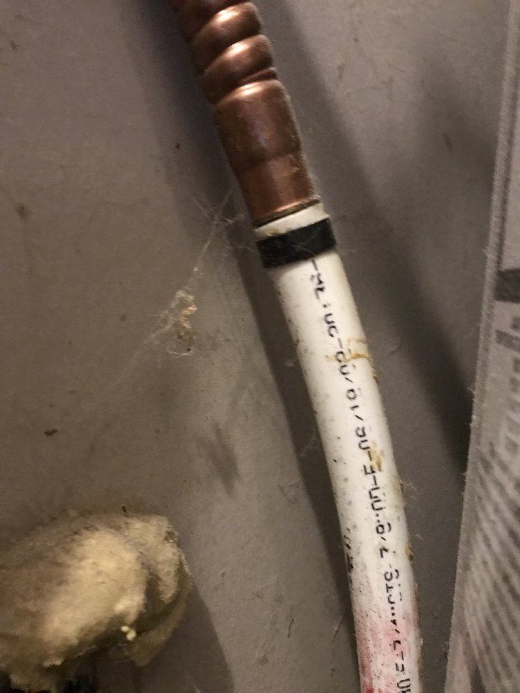

That pipe going up looks like they were going to add another line to something else. Weird way to plumb in another line to soemthing though.
You guys have really really bad water if that is 5 years old.
And that pan is no good, anyways. Its not hooked to anything. I am not sure what he codes are where you live but the water heate ris supposed to be 18 or 24" off the ground so if you were in texas, you should put a stand under it. It actually makes it easier to work on, too. your house looks older so that might be why its not on a stand though.
My houae is older and my water heate ris on the ground. It sucks to work on it
