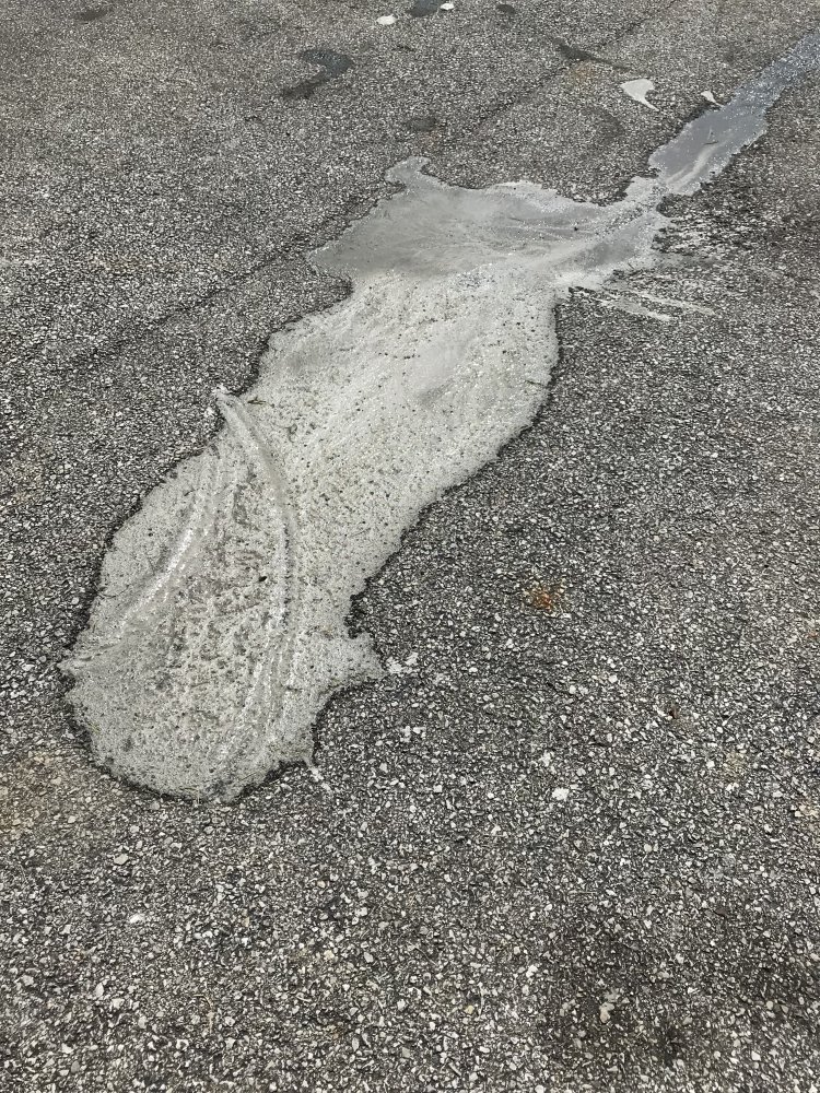

I think this place is a 2012,its a doublewide but on a block foundation and also has a 25x25 addition on the back. Got it out of the house. The water heater was actually wider than the opening to bring it out of. Had to remove drywall strips on either side of opening & move the wall a little as I was pulling it out. You should see the crap that came out of it once it was in the driveway. A lot of residue. Time to go shopping. Ouch.
Yeah, that looks familiar. My cats do that too, when they eat too much grass.
