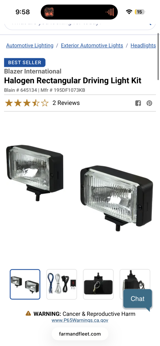

I got a 94 ranger and I’m figuring out why everybody always put light bars or roof rack lights or whatever you wanted but like any old truck has additional headlights because even compared to a newer style headlight setup non led they suck there isn’t no projection with them. I put in new bulbs and there better but not by much like in my opinion the brights on is what I want my normal headlights to be but anyway do I put a light bar on it? Or is somthing like adding auxiliary lights a better idea like driving lights from farm and fleet

Okay these ones say dot certified so is it ok to run them?
