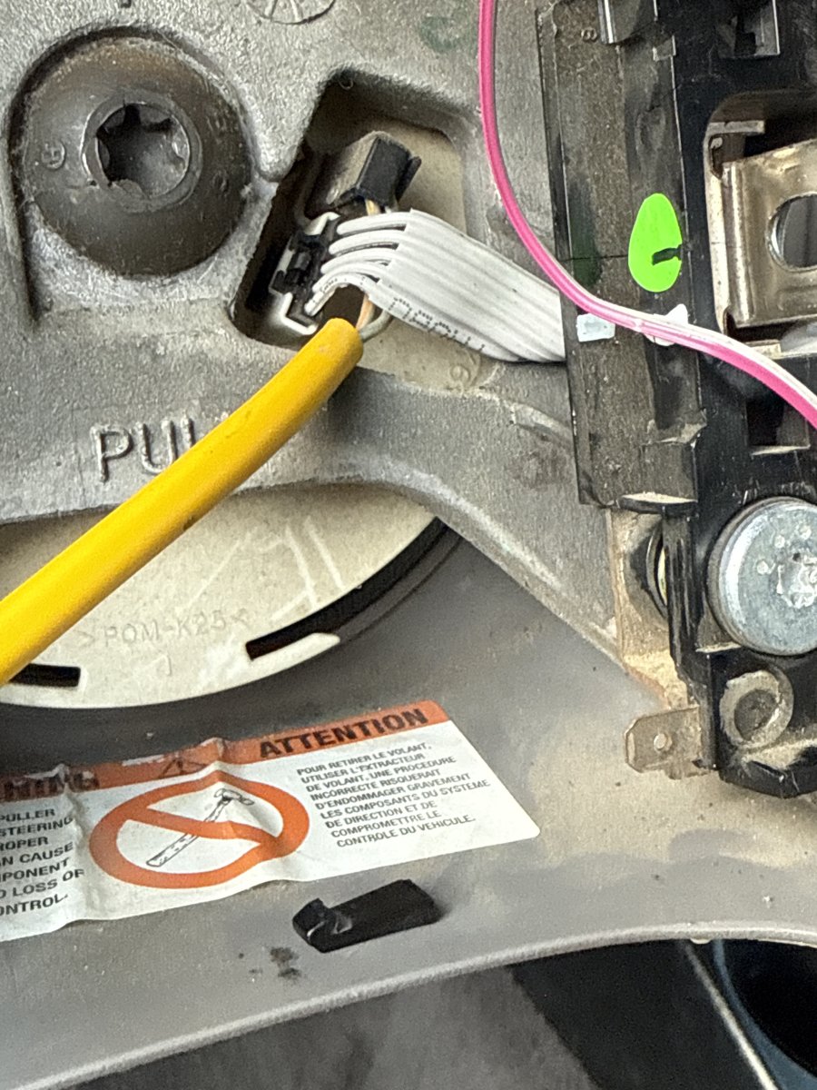

I suppose the screw I was thinking of was this small plastic black tab.
Plastic doesn't conduct electricity, so while that's not the direct culprit, if it held something that's part of the switches or clockspring, it could be a now-loose part that is causing the phantom horn blowing.
I am not seeing anything it was holding in. All the wiring checks out. ChatGPT says it’s most likely a faulty clock spring. Is it worth replacing?
Not that I can think of, on an intermittent problem while driving, short of putting a midget with a flashlight in the steering wheel to watch things while you drive.
