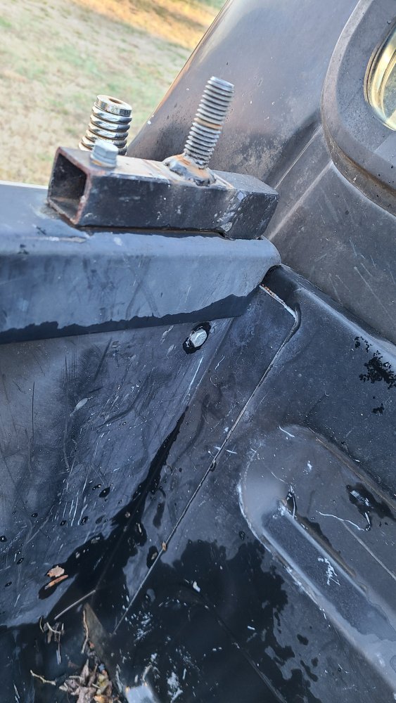

I made two brackets like this that bolt to the bed.
That allowed me to mount the jack across the front of the bed as seen in this picture.
Pretty simple I was hoping for these homemade posts thanks!

I will be creating something new soon, for my new bed. There are also mounts you can buy. But they seem pricey to me.

I have one mounted to my roof rack, I made two mounts out of a long 1/2" bolt and a piece of flat plate. It is mounted to the rack with little U bolts. The big 1/2" bolt sticks through the holes in the jack, and there is a nut/washer lightly screwed on, and I drilled a hole in the end of the bolt for a hitch pin so that the nuts don't work loose.
I did something similar on the other truck in the background, but I used carriage bolts up through the wood bed and just some big wing nuts to hold it in place. I wasn't as concerned with that one because it's just kinda sitting on the flatbed. You can kinda see it in the middle of the ladder.
