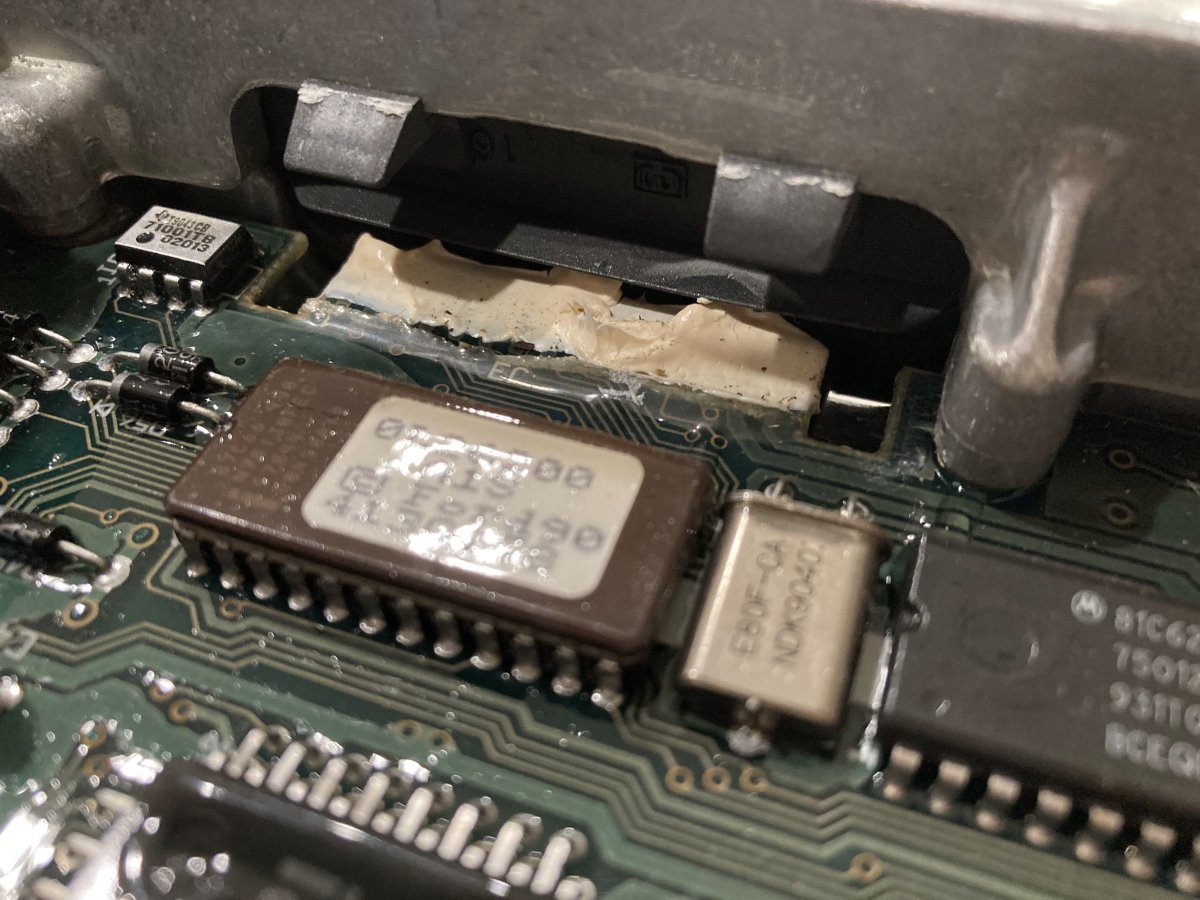

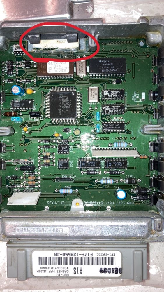

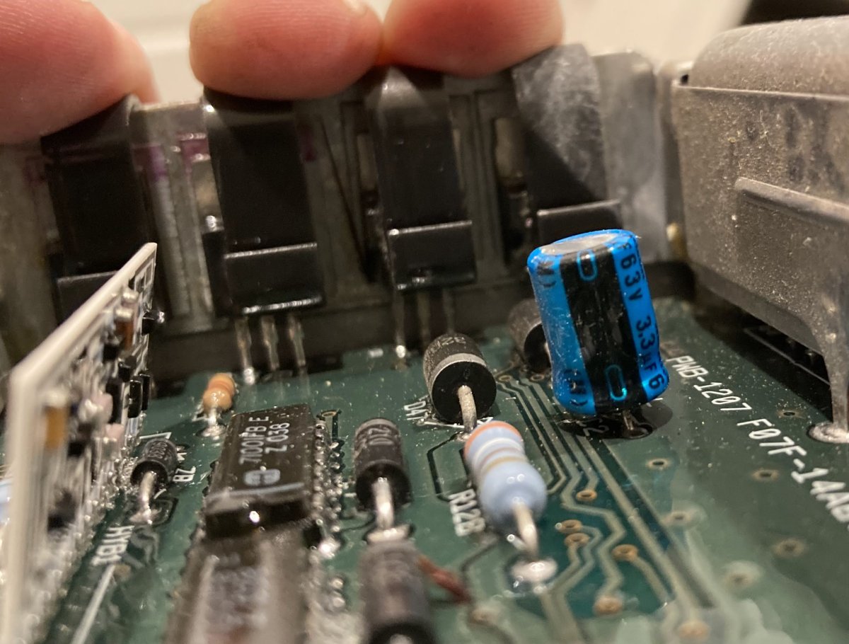

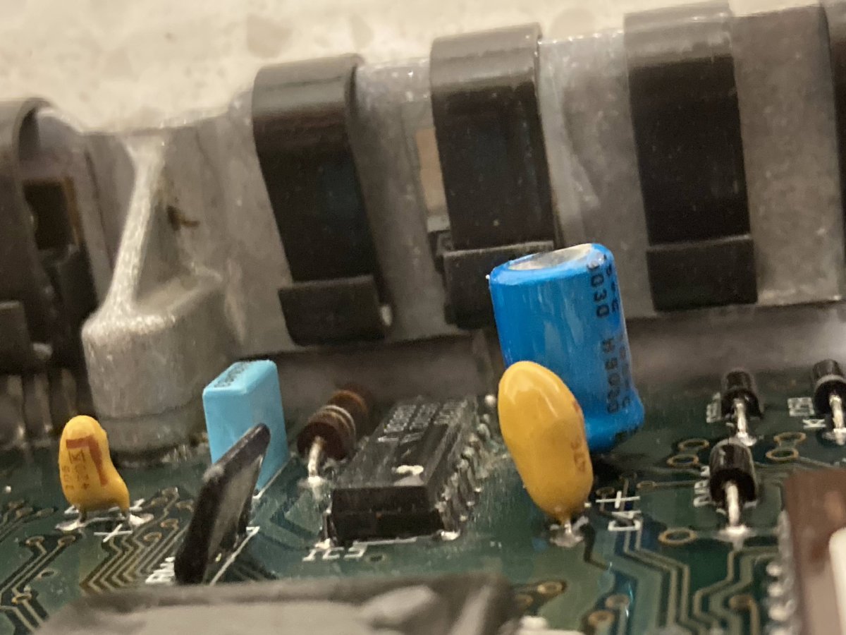

@RonD I opened up the ECU.
A couple things to note:
  1. The blue capacitors (there are 2) do appear to have a slightly misshapen/non-flat head (see pics), though they do not appear to be leaking.
  2. There is some white/cream-colored goo that I circled in one pic, near where there is a black removable plug in the outer casing. Could this be an issue? Or maybe this is just some sort of connectivity grease?

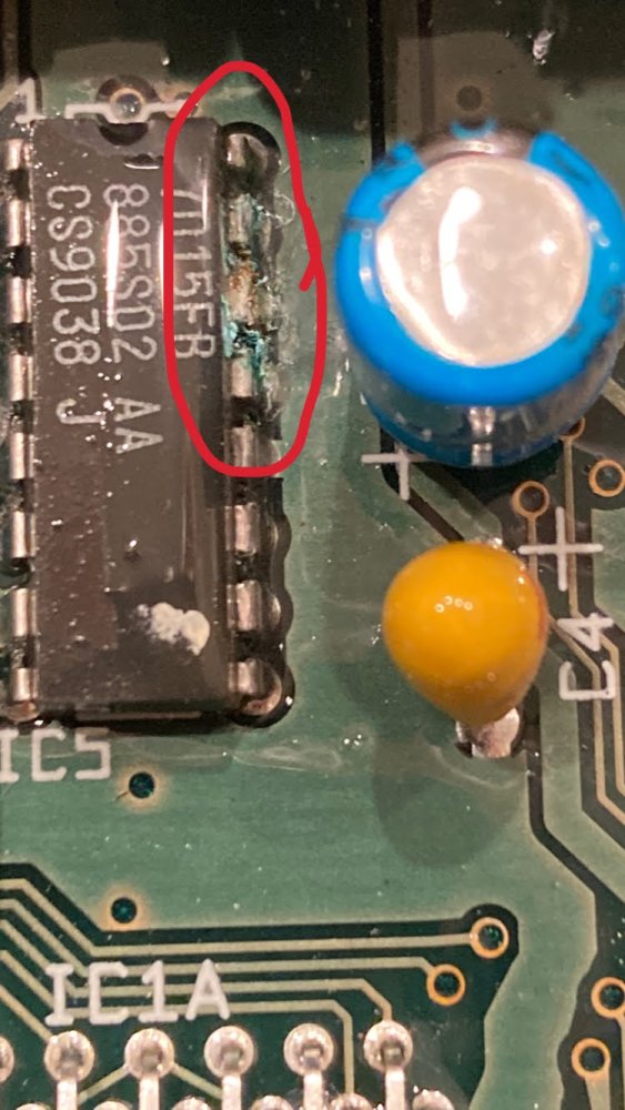

  3. I did notice a tiny bit of corrosion on one "chip", circled in one of the pics. I used a dental tool to very gently scrape away a bit of the corrosion. When I put everything back together and started the truck, the high-idle issue remained (no change).
Does anything jump out to you? Is there any way to test the computer? As in, plug it into a machine that tests it or something?

Replace capacitors for sure they are just about to leak and are no longer working
Clean up corrosion on the chip with Q-tips, isopropyl alcohol(90%+), small screw driver to scrape hard stuff off
White "stuff" looks OK, most likely heat sink silicone
