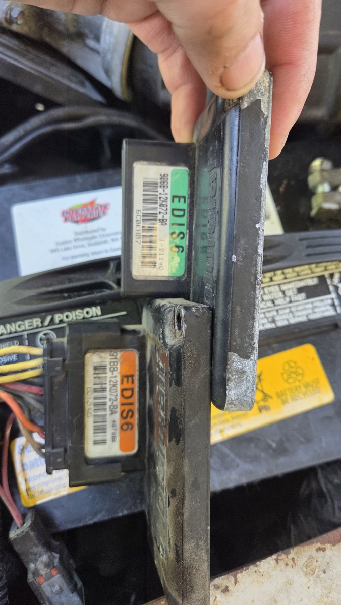

It's running on its own again! Ran to the salvage yard and picked up a cps and edis (ignition control) module for what a tank of gas used to cost in the day lol. Plugged up the edis and took a few crank but she fired up! Runs pretty smooth, idles great and happily revs! So I've got a spare cps, and she seems happy now. Only difference is the new edis I think is a newer version (906b vs 91bb). So happy its alive again!!

AFAIK, all EDIS models are compatible with the same number of cylinders.
