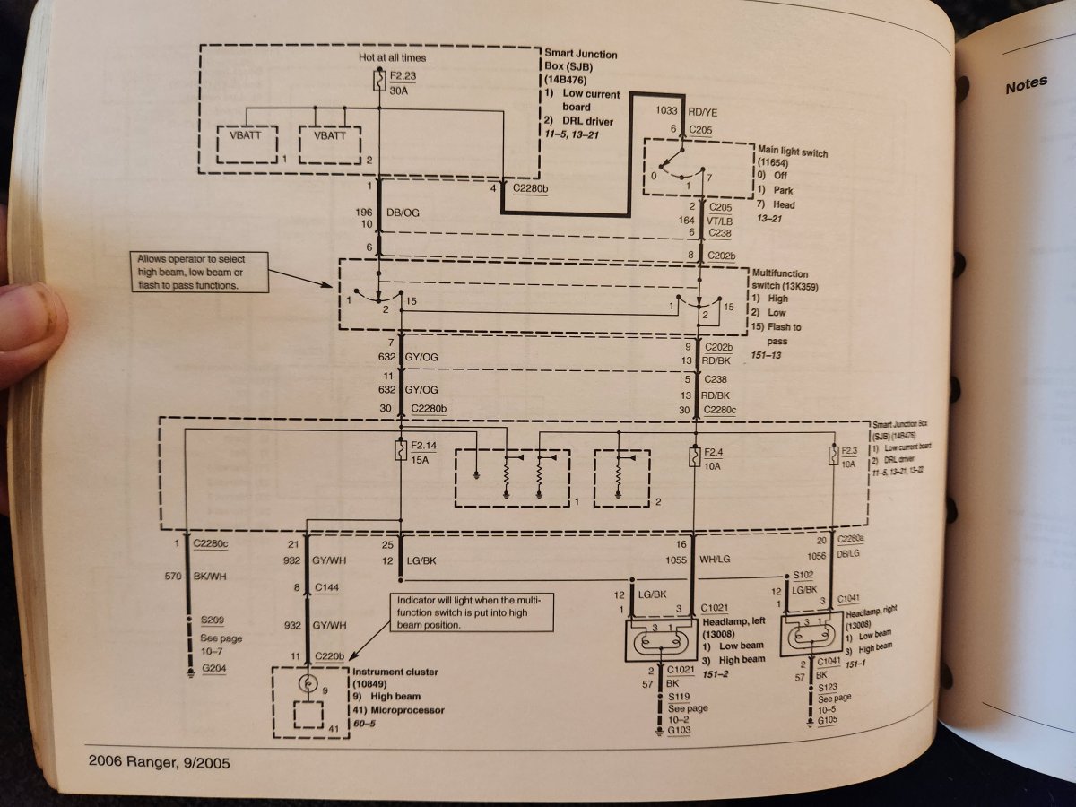

2004 ranger standard cab - If I push the the turn signal indicator forward for high beams, they don't work, flash to to pass works. Why?

So the indicator and high beams work... with flash to pass. That tells me wiring and fuses are good out to the high beams. Also tells me the SJB is also good. In fact wiring back to the multi function switch is good.
There is really only the multifunction switch left to be at fault.

It was a fuse. Pulled and replaced - all is good. Flash to pass worked, only high beams and indicator failed.

Ok... i thought i had read the high bean indicator worked. Also the fact I was thinking flash to pass was cycling the high beams on. A closer look at the schematic... clearly shows flash time pass is a low beam function.
