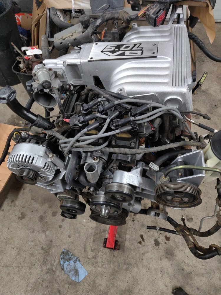

Hi, trucks at my dad's shop on the lift at the moment, so pics will have to wait, I did have a shot of the engine cleaned up and ready to drop in, linked below. More background on the truck: 2001 Ranger Edge 4x4 extra cab. Donor rig: 99 explorer V8, and a BW4406 transfer case.

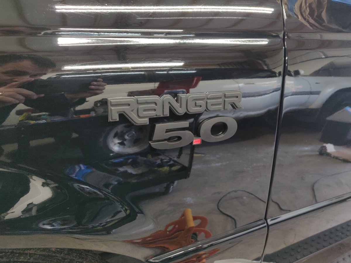

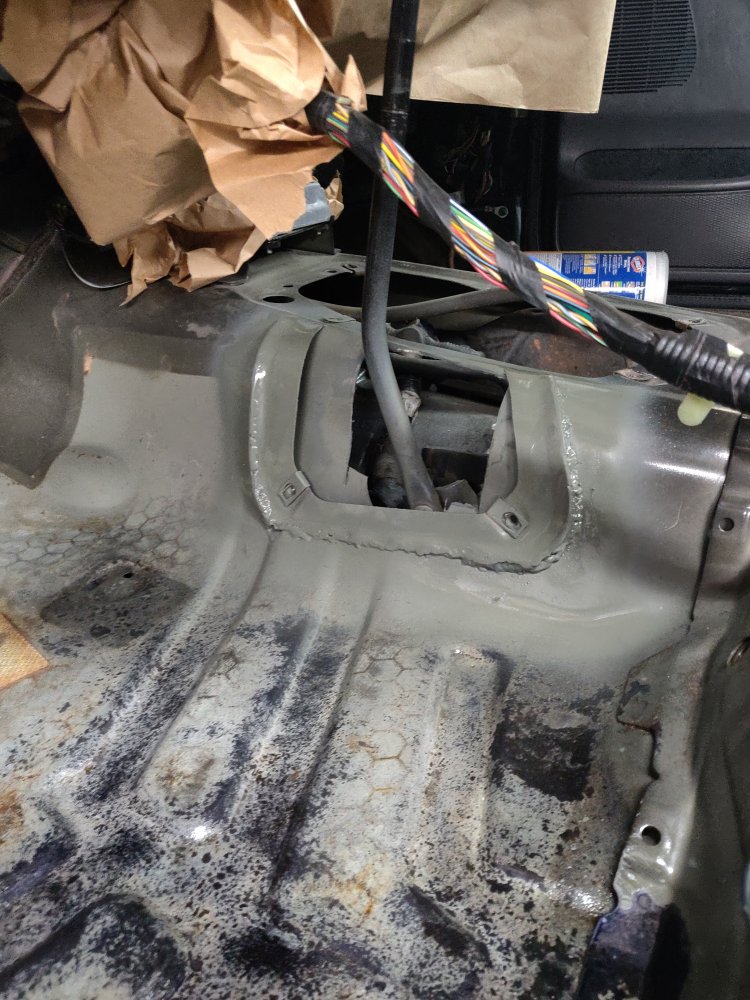

So I sold this truck to a friend as soon as I had it finished, but here are some pics I took before it left. I've already started collecting parts for the next build, a 2wd M/T 5.0 swap.
