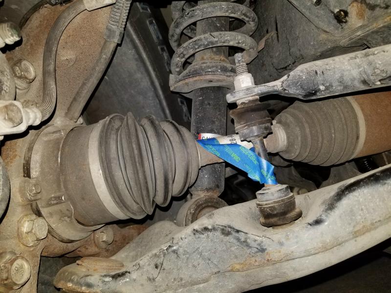

With the truck running and in 2WD, the front axleshafts shouldn't spin right? Engine vacuum should disengage them.
I took some blue painters tape, wrapped it around each axle, and attached the other end to a swaybar link. I backed down the driveway a little, pulled back up, and the tape was intact.
I drove around the block getting up to 25 MPH and pulled back in to the driveway to check the tape. The tape on both sides had broke and wrapped around the axleshaft, which tells me the front axleshafts are turning in 2WD. I don't get any noise from the hubs trying to engage on either side, I can just feel that the wheels are connected to the axle, and get a humming sound at higher speeds from the shafts turning.

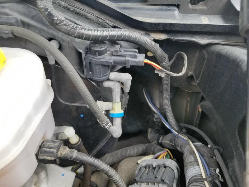

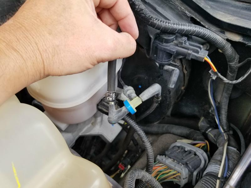

I disconnected the vacuum lines from the solenoid, and connected them together so that the hubs would have vacuum. When I pulled the hose off, I heard a lot of air escaping.
With the lines connected so that there's always vacuum, I did the tape test again on the axle shafts. Again, the shafts were still turning, and broke the tape.
With the engine off, I jacked up the truck and spun the wheels. They spun freely from the axle shaft because I still had the vacuum hose stuck together. This tells me that the 4WD hubs are working, and that the lines are holding vacuum.
