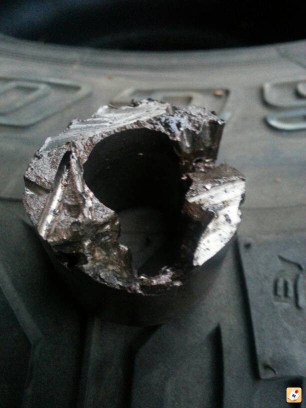

yesterday did not go well...the special fork i bought did not remove the camber bushings and i resorted to cutting one of the lips off of the bushing and now im drilling it out! slow going as i dont want to damage anything...what a day! anybody have any ideas for when i get to the other side???
