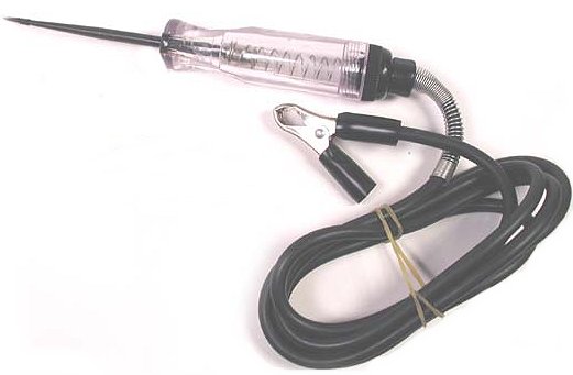

i think ull need a voltmeter or light tester to check if ur getting voltage to the ignition/accsesories wire and the 12v memory wire.
i meant test light
easier to use and cheapier than a voltmeter
