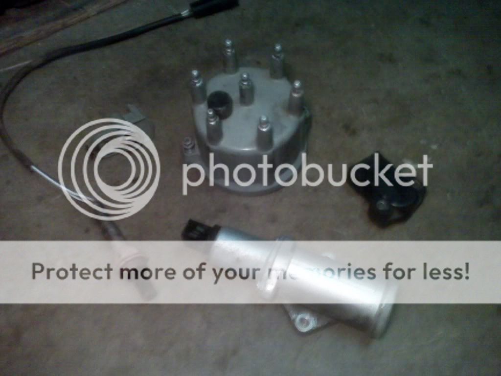

Well found out it was the TPS.
I ended up deciding to replace all of this anyway at some time so just knocked it all out at once. Replaced my, O2 Sensor, TPS, IAC, Cap and Rotor.
The old Stuff.
