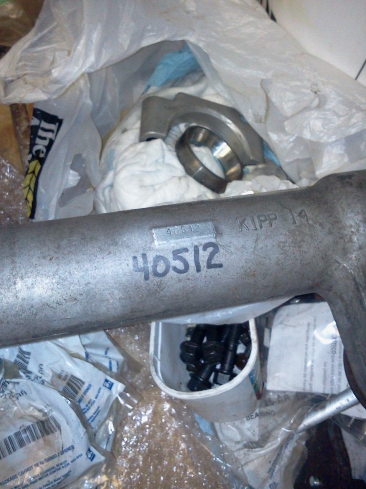

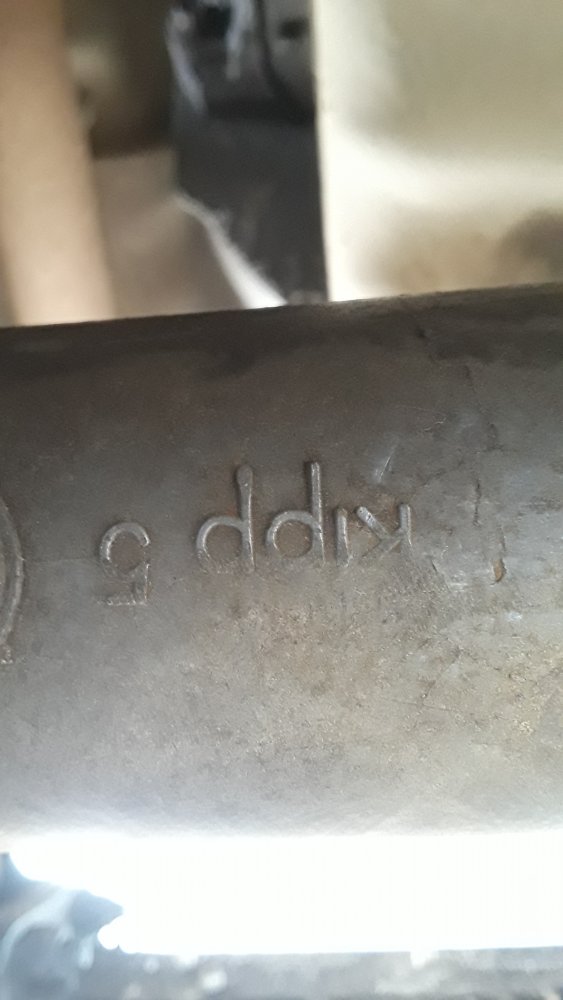

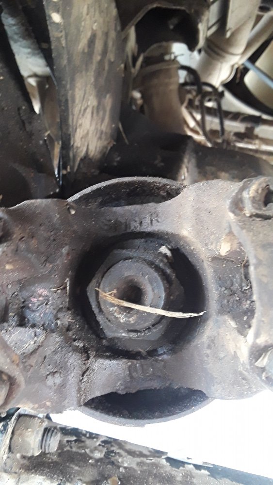

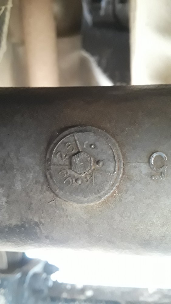

Hello, so I have a 99 ford ranger 3.0 4wd manual, me and a friend are going to rebuild the front axle and get my 4wd working I need to order bearings and seals. However am unsure of what ring gear and type of axle I have up front. I know I have an f6 rear axle code so I have a limited slip 7.5" 3.73 rear axle; but I cant find a bom(build.of.material) number or a sticker on the front axle it does have some engraved markings though I've included some pictures of the stamps on the passenger side axle shaft housing and the area where the driveshaft attaches to the front axle. Any help or information Would be appreciated.

none of those pictures show anything important.
there should be a 5 or 6 digit number on the tube starting with 4 (??)
I've had good luck using year-make-model for the front axle bearings & seals.
the drivers side bearing is the same as the rear axle bearing.
the 5 digit # is stamped on a small raised pad. that's the Dana # for what it is.
33064
