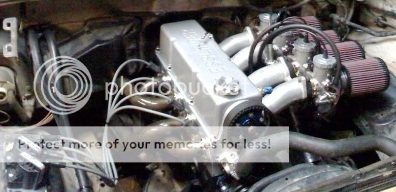

Can you or someone answer THIS question! How is this guy running THIS setup? Its like coilpacks or something, but its def. distributerless RIGHT? WHAT IS HE SPORTING?
Looks like he spent the big bucks, and the trouble to go to the stand alone EDIS (distributorless) ignition.
Looks like he bought the esslinger ignition kit. I want to do a setup similar to this using my 8 plug head.

That setup looks much simpler than the stock 8 plug head.... Do you get any "real" power with this upgrade or is it just for the simplicity of everything. There's a Bayliner Boat for FREE on CL right now, FREE, with the 2.3l motor! I'm about toto contact him and see if he will let me pull the head and manifold.
I like to keep it simple (the bad thing about the Esslinger distributorless setup is what happens when the box craps out? =$$$. Plus you'd probably be stuck on side of the road somewhere). On the 2.3's letting it breathe is the key to power (bigger carb, etc). If you are running a 2.3 with a stock carb setup then swap it over to a Holley 350 cfm 2bbl you should see a very noticeable increase in power (provided you have it dialed in right). A better carb on a 2.3 usually gives you the most power gain per $$ outside of a turbocharger.

The Esslinger ignition kit $865.00 http://store.esslingeracing.com/cart/electromotive_crank_fire_ignition_kit-details.aspx
An awfull amount of money just be distributorless!
